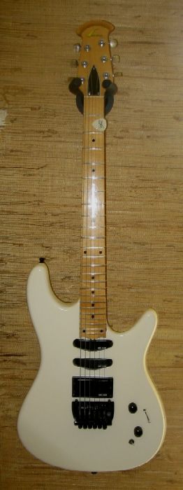

It started out with Cruster asking cwkII if Ovation ever made a strat body with an Ovation headstock. Stonebobbo had bought his son a celebrity electric, but it developed a cracked headstock during shipping. Moody,pi offered SB the orphan neck from his Viper. SB bought a set of vintage Shallers with pearl buttons on eBay. A little dremel here, a little redrilling of neckbolt holes, and the result is in:
I've posted more pics in the gallery under "StratoViper". There's a picture of the original guitar in the Ovation folder in the gallery.
This thing plays unbelievably nice. It's a bit of a snakehead with a bit of poisonous bite. I've got it pretty well setup, but I'm sure it'll settle out over the next couple of days and I'll tweak it into perfection.
So now it deserves a name. StratoViper? Vipercaster? AspKicker? You can tell I need help here, folks! Suggestions kindly accepted and appreciated. :)

Are you SURE that the scale length is right? It looks like it's off in the picture.
Posted 2004-12-27 1:01 AM (#168627 - in reply to #168619)
Subject: Re: Class Project

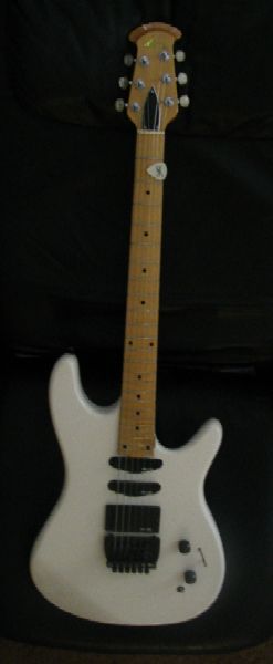

Scale length is dead on at 25.5" ... and just because I'm paranoid I just went and measured again. :) The scale looks bizarre because it is not a Strat body (and we are conditioned that a Strat has certain dimensions) ... that and also the camera angle from which the picture was taken.
The donor guitar was a celebrity electric which originally had a 24 fret neck ... I did a lot of measuring and comparing to the neck that came off the guitar, and ended up taking a small amount off the heel block and reshaping ... the Viper heel block was a square Tele style while the body required a slightly rounded Strat style. When I fitted the Viper neck, I didn't need to even move the saddles as the intonation was within a couple of cents of perfect; not noticable without the help of an electronic tuner. I will put it dead on once I let the guitar settle out for a week or so.
As a control (and an experiment), I did take the neck off my Strat and looked at what it would be like to put the Viper neck on the Strat ... now THAT would have resulted in scale length problems (even though the Viper and the Strat are both 25.5" scale length, the Viper neck is a little over 1" longer from nut to end of heel block). The saddles on my Strat don't have anywhere near the 1/2" of additional travel it was going to require to intonate properly.
Here's a more straight on picture to show the scale length ... sorry about the flash wash.

Much better. That first picture was making me cross-eyed.
