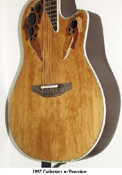

Does the 1987 Collectors have a floating fretboard like the 1537's?
Take a look at this and tell me what you think.

Must be a horrible defect...looks like the fretboard is going to curl up. However, a good wood screw will hold it down. :p :D :p
Posted 2006-10-13 2:04 PM (#236475 - in reply to #236473)
Subject: Re: 1987C?
Partially floating, not as much as the 1537.

My guess is the neck needs to be reset. That's an awfully big gap.

I have the 87 and I thought it was glued down. cwk2 should know. Is this partially floating unique to the 87? And how much is floating?
Makes me want to pull mine up and see. maybe not.

However, the seller describes this as a flaw.

the one I have (borrowed) looks sealed to me...bet this one sings.

By the way, this 1987 Collectors - this is the way bearclaw should look. Not the greatest picture but notice how great the top looks, a dark honey.

I think the fretboard is going to curl up. Defect! Pretty sure. Please take a look, two guitars.

I don't have any space under the fretboard on mine. Maybe there's a shim under there.

There is one blurry auction picture suggesting a floating fretboard. I stand corrected. It is floating, but not in the sense that we want.

I pointed out to the seller a handfull of issues that I felt were important to note in the auction. I offered to take pictures of the issues and post them on the Board for the seller.
Posted 2006-10-18 1:42 AM (#236507 - in reply to #236473)
Subject: Re: 1987C?
Earlier, I talked to Bruce...we need to be more specific here.
There appears to be major and expensive problems with this guitar. Listening to what Bruce found, I believe that the auction needs to be cancelled and then restarted. High bidder should rescind his bid (Bruce).
This isn't a "floating fretboard" - Mr.Ovation (Povation) wins the prize.
Anyone bidding on the guitar should project $250-$400 repair bill from the factory. This means that high bid should probably not be greater than about $350.

WOW - thanks for the work on this Tony & Bruce. That could have been a BIG disappointment, not to mention costly.
Posted 2006-10-18 2:02 AM (#236509 - in reply to #236473)
Subject: Re: 1987C?
From what Bruce told me, the seller wasn't trying to misrepresent. "Eagle Eye" was on the case...even offering assistance. Bottom line, they should cancel auction and send it to factory, then relist or relist as a project, full disclosure, then the buyer sends to factory.
Personally, I wouldn't pay more than $350, have it sent directly to the factory by the seller.

The description is fraudulent or incompetent (your choice)- you choose...within the OFC, who gives a rat's ass about the signature. Any one else, buyer beware. Number of OFC'ers who have bid.
This has a serious problem with the neck that Eagle Eyes saw today...they now know the problem. An OFC'er who received this would know they had been screwed.
Buy it for a signature or wall art...as an instrument, it needs the facory and $'s.

Posted 2006-10-18 6:36 AM (#236518 - in reply to #236473)
Subject: Re: 1987C?
Posts: 1673
Tony, Are we turning into grumpy old men?
Miles, The seller did tell me that he was going to amend or pull the auction when he got home.
There are numerous neck binding cracks; possibly a half inch tight crack in the neck on the treble side starting at the nut (we both thought it was a crack, but I would hold judgement until it could be looked at under magnification); his blurred picture of the fingerboard does not depict its current upward curve with the substance underneath it pulling apart like old caulk on your bathtub (I have no idea what the substance is, it is whitish/opaque); the heel does not appear tight to the bowl; the cowboy frets are grooved, the frets show wear, the top is bellied a little behind the bridge with a corresponding dive in front effecting the break angle over the saddle; we were sitting on a bench outside a resturant so we have yet to see if the electronics work (the preamp was not the cleanest looking area and the screws looked rusted); the strings were old and corroded; a previous rusted string left marks on the fretboard where the case pad presses down; the case has a large area of bubble and damage;...
Even with all this stuff, it is still playable. No finish cracks. The top looks nice. The ebony board just needs a good cleaning. I told the seller that only an Ovation would have survived. It is obvious that the guitar has not been stored correctly at some times during its life, but a proper reset would resolve the major issues. The cracks in the neck binding we've all seen before... the binding and inlays appeared stable. I was able to run my fingers around the edge of the top and a up the neck and not find any significant bumps or bruises.
IMHO, The current description and pictures in the auction are lacking in disclosure of the guitar's current condition. I told the seller that I would not be happy with all these surprises. Offering a return policy is not an ethical way to skirt around proper disclosure of an items condition.
Bo Diddley's signature is really kool, but if I was going to factor it in on a purchase, I would be looking for authentication.
