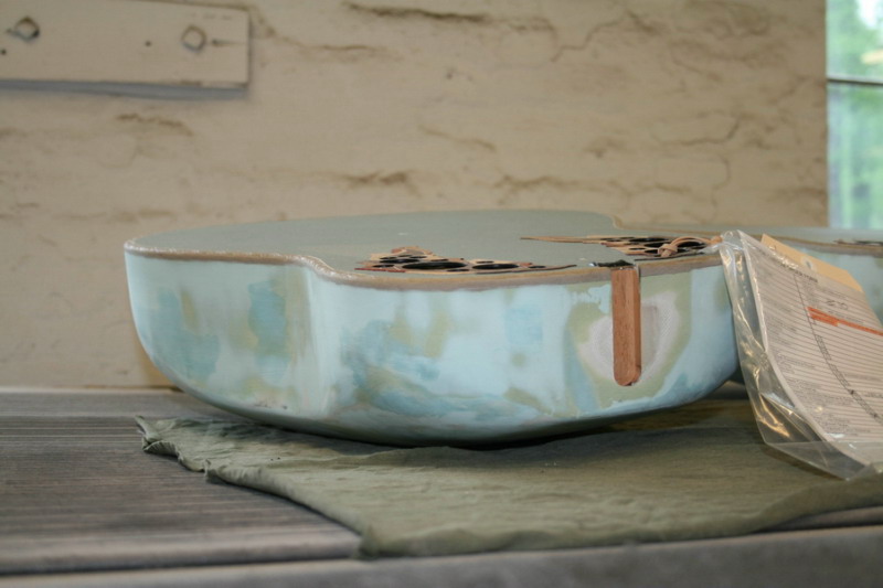

Your serial numbers tell me that both bowls were hand-laid, vacuum-bagged over the male molds. Are you able to feel any texture of the fiberglass cloth weave with your fingers on the inside of the bowls?
Interestingly, in Pic #1, the bowl almost looks like there's some print-through of the fabric weave showing in the reflection of the neck. Is this just a weird reflection or can you see the weave of the fabric?
Pic #5 is also very interesting to me. I see several things.
1) It looks like the epoxy glue holding the wood block into which the strap button is screwed has let loose at some point.
It almost looks like the original 'doubler' was replaced at some point with the wood block shown in the photo. I say this because the block doesn't look like it would fit into the glue joint.
Do both guitars have this type of wood block or is one different from the other?
2) The inside of the bowl looks like it was sprayed with black paint because of the masking effect where the paint was not able to hit that allows the bare fiberglass to show through.
This is the other reason why I think this wood block was not original. It's bare wood, but missing paint below it shows the original 'doubler' was there when the inside of the bowl was sprayed.
3) What is that? It almost looks like some sort of sponge foam.

Yep. Your description of the 'thinness' of the bowls sounds like a hand-layup to me.
If you look at PP.13 of the 2007 Ovation Factory Tour on the Ovation Tribute site, you can see several hand-laid bowls in their 'natural' state. (See: PP.13)
The 'blueish' color looks to me like the primer. Where the primer has been sanded through, the natural fiberglass resin shows through as the 'greenish' color. The 'whiteish' color around the neck slot in the top of the body is where the skin of the molded fiberglass resin as been sanded through and is showing the interior of the fiberglass resin/cloth, itself.
I have an `82 1655, which was the first year of the SMC bowls and it's noticably thicker and less flexible than my 2078. The later Lyrachord GS bowls also seem vibrate more than the early SMC bowl. (belly rumble)
In fact, I've found that the back-door adds structural integrity. Whenever I remove it, the bowl is more flexible than when it's tightly clamped into place.

On the early Balladeers, there was a horizontal strip of fiberglass tape on the underside of the top.  Somewhere there's a drawing that shows it, but I can seem to locate it tonight.  Here's a photo from an an early Balladeer.  I'm not sure what that strip is the picture you posted.
Nick

Print through is pretty common in the fiberglass industry and it's more of a visual problem than a structural one. It's usually caused by the resin shrinking or too much vacuum being applied to parts being vacuum bagged. It's also more of a problem with darker colors than lighter ones. It could be that during the course of its lifetime, this guitar sat in a stand for a while in a sunny spot.
There are ways to minimize it, such as laying down a layer of cloth with a finer weave on the exterior layer, which is what I do. Personally, I wouldn't worry about it.
1) Aha! That makes perfect sense.
3) I looked at the original patent documents and it looks like this may just be the fiberglass reinforcement.
It's interesting that 485 has a wood brace but 1911 does not. It's also interesting that 485 looks like it has a lot of excess resin on the back of the sound board while 1911 is almost perfectly clean wood in this area.
With instruments this old, it's nearly impossible to determine what kind of life they've had and what's been done to them over the years. It could be that some luthier who was ignorant of the early Ovation construction added the wood brace to 485 somewhere along the line.
Personally, if 1911 plays well and isn't bellying, then I wouldn't do anything. If the MS looked at it and gave it a passing grade, then I would leave well enough alone.

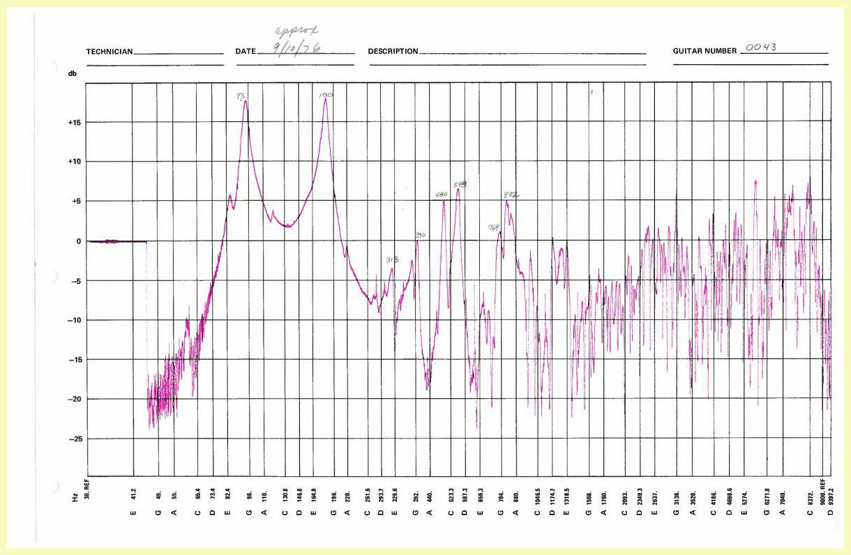

TJR recently sent me some pics I thought were very interesting, so I thought I'd share.
The first two pics show a 1st Generation hand-laid bowl.
As someone who's done this type of molding there were several details that jumped out at me.
If you read 'The Book', the process for making laying up these bowls is described on PP. 26.
While the 2x2 twill weave cloth can easily form over this kind of shape, the clear plastic sheet is used for for molding over a compound curved back cannot fully conform to the shape. It folds over and wrinkles when the vacuum is applied. This produces the characteristic ridges and valleys we can see in the photos along the sides and radius to the back. Once the resin has cured, these need to be sanded smooth, which we can see in this bowl.
TJR relates that this bowl is noticably smaller than the modern bowl he sent me and would fit inside the modern bowl with room to spare.
In this next photo we see a laminated wooden plug.
This is from a very early development period. We can tell this because of the slab sides and lack of radius between the back and the sides along the upper and lower bouts. It also has more of a dreadnaught shape rather than the pinched-waist OM-style used by virtually all Ovation guitars.
I suspect this was from a mid-step engineering test between the flat-backed fiberglass design and the fully-radiused design seen in the pics above.
This type of construction is fairly normal for mold-making. Being solid wood, I'll bet it weighs a ton.

Here's a couple of pics of the newest generation cloth bowl. This is the same bowl I used to mold the patch on my 1619-4 Repair thread in the BFLG forum.
Here's a couple more pics of the 1st gen cloth bowl.
Here's a pic of the 1st gen bowl inside the newest gen cloth bowl. As you can see, they've gotten larger over time. This is not caused by shrinkage. Usually when epoxy resin shrinks, it just makes the parts thinner, not smaller.
Here's a pic of the 1st gen wooden mold and and a cloth bowl. What you're seeing here is worth noting.
First, the mold is a lot deeper than the bowl. This is because when when vacuum bag molding a part, you have to allow space for the plastic bag to fold over at the base of the mold. This is the same principle used for vacuum molding plastic parts. You need a little bit over overhang which must be trimmed from the final part.
In contrast, a female mold can be made to net depth because the part can be trimmed to the top edge of the mold.
The bowl has had the neck and heel blocks glued into place and the upper part where the kerfing would be glued has been masked, then the whole interior of the bowl has been sprayed black.
The sharp angle of the neck block shows us this is a very early bowl, probably 1965-1966.

I took these these pictures just prior to the Slothead reunion - an epic event - first time in my life MY GUITAR was invited to an event and I got to tag along for the ride.
We wanted to determine which original pre-production slothead mine was - as the original label was long gone (The factory pulled the label off!). Darren wanted to look at it for a couple weeks because this particular guitar - once it got to me was played on the road for 2 dozen years - minimum 6 hours per day. Folks who have played it can really attest to the fact an Adamas will open up. They were in the process of making the reissues - so having instruments around to compare to was fun. Curiously they numbered and wrote weights on the braces in pencil - enough got documented when it was made - that all Beal, Darren, and Nick Macklin had to do was refer to the old large blue print records. Turns out it is #43, which has a storied "out of the factory-back into the factory history" It actually went out - came back - then went out again. Not sure what these pics tell you Dan, but here goes.

Here are a few bowl pics from 2005, the blue print records, a stunning cameo of a pre-production Q, Bill doing the honors once it was determined to be #43, a blurry historical shot showing both Timm Kummer and Uncle Beal can play guitars...Cliff made the culminating photo for the calendar - but this one is the amateur photo hour version - with the kodak instamatic. Memories from the older guard.

Dan Savage: I found the plot Darren did in 2005 of OSH #43. I am curious what you say comparing the two plots with 29 years between them.

Unfortunately, the two plots use completely different notation and I don't know how to read the new plot.

I wonder how these vibrometer plots were made. What is input and what is output? The newest plot says "Swept sine wave" and is probably made by a microphone recording the sound emitted by the guitar at some distance with a vibrator/driver of some kind attached to the bridge. Such vibrator/driver can be a good tool when designing the sound board, but I would guess that the top/bracing/suspension design was done by experiment and judged by ears as normally done and the vibrometer measurements were done afterwards driven by curiosity and in effort to describe the result somehow. At that time frequency analysis of mechanical systems was really hot.
If the two plots were made in identical conditions they might the some of how the guitar soundboard changed over the years. To make such comparison be meaningful require a lot of experience in analysing and comparing these plots. It does seem that the two pronounced peeks at 90 and 183Hz have leveled out. This frequency interval corresponds to the interval of fundamentals from G on 6th string to F# above that. This, I believe, is good since such peaks also might indicate either a local resonance or less damping in that area which would make the guitar resonate differently - maybe less controlled - around these frequencies. Wolfnotes - such are also discussed in the article Dan refers to.

TPA - Darren Wallace wanted to measure the guitar to see what 30 years of playing it did to it...though it cannot be proven, it is likely due to its history, that #43 has had far more playing on it than any other of the originals. I will see if I can get Darren to chime in comparing the plots.
