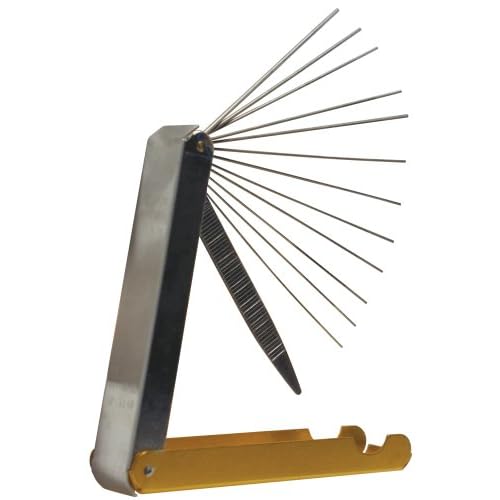

If you can't afford nut files (which are very expensive), go to Home Depot and pick up a Welding Tip cleaner file kit for about $5.00. For the occasional job, they work just fine, except the B & E strings. you will have to use an X-Acto saw for those, the slots are usually too thin. In a pinch, I've just used a razor knife for those strings.
YMMV of course.

photoweborama
Posted 2013-02-22 1:28 PM (#465694 - in reply to #465666)
Subject: Re: Filing a nut without a nut fie?
February 2013
Posts: 16
Location: Sacramento, CA
I guess I should have included a picture of the welding tip cleaner set.
They have been very popular on other guitar forums. The set includes a series of round files that can be used to properly cut the bottom of the nut slot with a nice round bottom.
