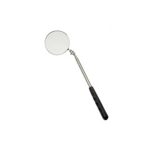

Posted 2013-08-16 1:37 AM (#474039 - in reply to #474037)
Subject: Re: 1861 Standard Balladeer scratchy preamp
arumako - 2013-08-15 10:49 PM
Any insight on how the piezo element plugs into the "thinline" preamp? Thanks again!
No... You need to get an inspection mirror.
arumako
Posted 2013-08-16 2:49 AM (#474040 - in reply to #473439)
October 2012
Posts: 1093
Location: Yokohama, Japan
Ah yes, the inspection mirror! I'll get one of those right away!
