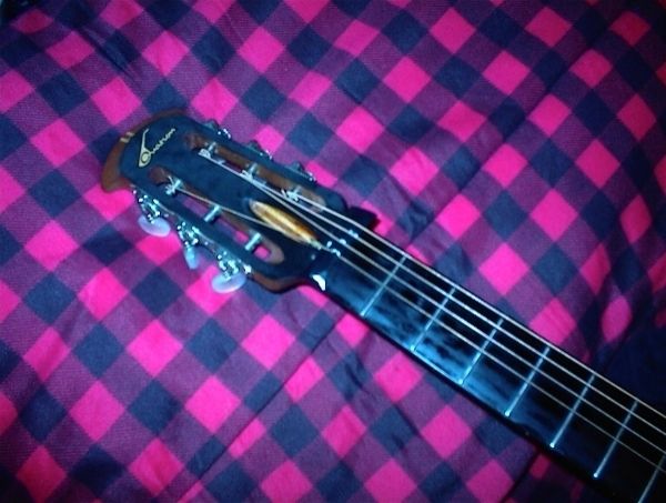

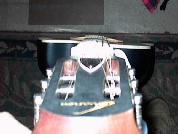

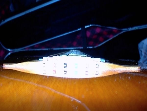

Okay, I just noticed this...
See how it drifts-off towards the treble side?
This might have been going on for a while, but I just noticed it.
And like MIB pointing-out the the TRC is off-center on my K1111-RI...
Now that I have noticed it, I cannot NOT notice it.
It still plays fine, no buzz and the intonation is almost perfect.
So, what caused it and how do I fix it?

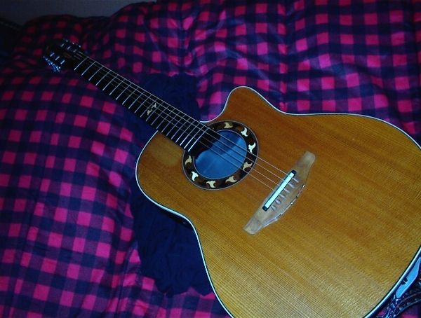

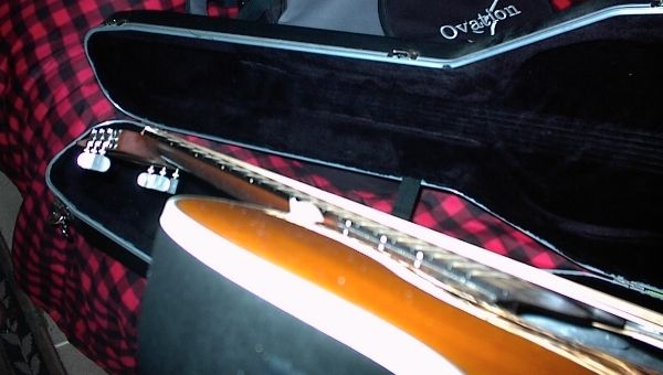

Okay... I decided to give it a shot.
So I removed the strings and the TRC.
I oiled the Truss-Rod Nut with Mineral Oil (it's what I had).
I also spread mineral oil on the fingerboard while I was at it.
Normally I ain't so sloppy...
I Loosened the TR nut enough to get the oil in on the threads.
I only put 4 strings back on, in reverse.
I tightened the Truss Rod a bit.
I tuned the strings up a half-step from standard tuning and put it in it's case.
We shall see what happens in a while.
