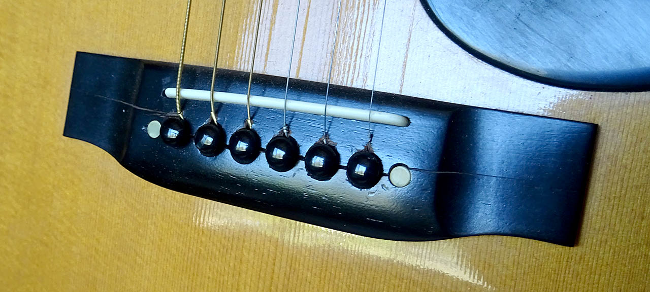

Bridge is being glued.
After this is dry, I'll fit the neck, then glue the rosette.
I'll wait to glue the neck until the final clear coats are applied to it.

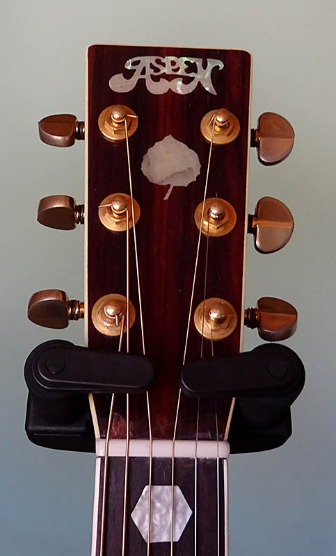

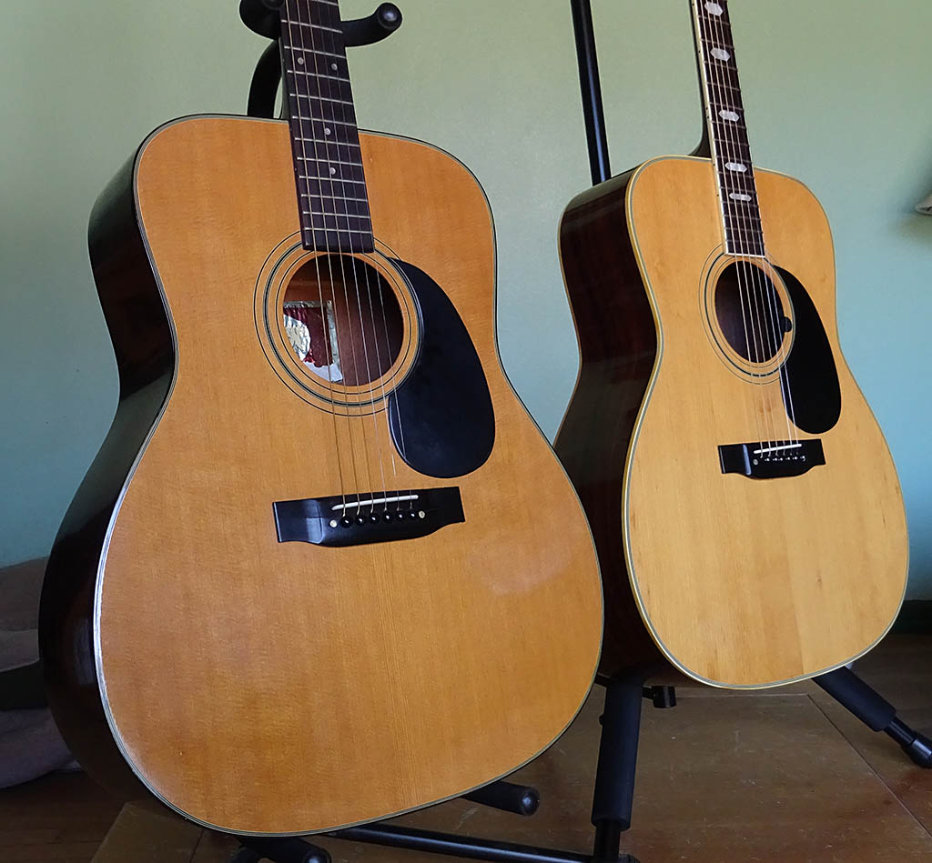

All done. I'll let the photos speak for themselves.

That's a beauty! How does it sound?

June 2012
Posts: 2347
Location: Pueblo West, CO
Yes, it is. Even though there are a few flaws here and there, all in all I'm very happy with how it turned out. I'd be proud to have this one in my stable, but even prouder to have it in your stable.
It sounds good. As a SS bowl, it doesn't have the same resonant sound as a deep bowl, but it keeps sounding better the more I play it.
Interestingly, torrefied Adi spruce has a tighter sound than torrefied Sitka spruce. As Paul has noted on his 1117 thread, his Adi-topped guitar continues to loosen up the more he plays it. Even though I've only been playing this for a few hours, I've noticed the same thing with your guitar.
It almost makes me want to put it on the primeVibe for a few days to loosen up the top.

1979 Aspen AD-35 vs. 197? Ovation Custom Ultra
Here's a video of a quick comparison between the two guitars. They probably couldn't be more different; Dreadnought vs. Super Shallow Bowl.
Both are beautiful playing and sounding guitars, but to my untrained ears, the Custom Ultra has a little more clarity of sound than the AD-35.
Please don't mind the playing. It's just my version of struggling banjos.
Edited by DarenSavage 2017-05-19 4:29 PM
Love O Fair
Posted 2017-05-19 10:33 PM (#535240 - in reply to #531529)
Subject: Re: 198? 1528-9 Ultra...
February 2016
Posts: 1888
Location: When??
@Daren - "1979 Aspen AD-35 vs. 197? Ovation Custom Ultra"
Both are very nice guitars, but Ovation wins (again). Also sounds quite rich for a shallow. Pretty, too!
After listening for the second time, I'm curious.. what are the bracing patterns for the two?
Edited by Love O Fair 2017-05-19 10:38 PM
DanSavage
Posted 2017-05-20 8:03 AM (#535242 - in reply to #535236)
June 2012
Posts: 2347
Nice video, Daren.
Al,
The AD-35 has Martin-style X-braces and the CU has Ovation K-5 braces, which is a variation of the A-brace pattern.

arumako
Posted 2017-05-26 10:37 AM (#535295 - in reply to #535236)
Subject: RE: 198? 1528-9 Ultra...
October 2012
Posts: 1093
Location: Yokohama, Japan
DarenSavage - 2017-05-19 6:27 AM
Thanks for the additional video Daren! That Aspen is in great condition and sounds superb! Did they sell those in the States new? For those of us in Japan who could never afford a Martin, we bought those, and other Martin copies, back in the day. They still are a great value for the sound. I think they were made by the Tokai factory. Very nostalgic piece there! She does seem to have a mellower voice than the Ultra.
Your Custom Ultra has a really clean punch to it, that is so characteristic of the Os, but she seems to have more of a natural chorus, and has an impressive...sensitivity/dynamic range...to it. I really enjoy these comparison videos. Thanks for taking the time to share!
Edited by arumako 2017-05-26 10:38 AM
DanSavage
Posted 2017-05-26 6:51 PM (#535304 - in reply to #535295)
June 2012
Posts: 2347
Hi Ken,
Yes. The Aspen guitar line was imported in the 1970s. Importation was stopped when Martin sued, not only the company importing the Aspen line, but also Alvarez and a whole host of hangers-on.
I agree. The Aspen guitars were one of the Japan imports that were a great value for the dollar, just like Yamaha.
The story behind this guitar is that when Daren and I were teenagers, we were avid about learning to play the guitar. Around our 17th birthday we were taken to the local music store to try out guitars.
I fell in love with a Yamaha FG-260 12-string and Daren, with an Aspen AD-18, which was a Martin-clone. Daren got the Aspen and I got the Yamaha.
The Aspen AD-18 has a solid Sitka spruce top, X-brace, Mahogany sides and back, ebony fingerboard and bridge. After a few years, the bridge split, rendering the guitar more or less unplayable.
Fast-forward to the present. I went to a local guitar show (think: swap meet) to pick up the Ovation 1717 hulk. While I was looking through the guy's extensive collection of guitars for sale, (50+) I spotted an Aspen AD-35.
The AD-35 was a short-lived model in the Aspen line-up. It was their top-of-the-line model. The top was AAA Sitka spruce with an X-brace pattern. But, what makes these guitars really special is that in the 1970s, Aspen was using solid Brazilian rosewood for the sides and back wood.
When I spotted the late-70s AD-35 for sale, I checked with the accountant (SWMBO) and told her that I thought this would be a really kewl Christmas present, I was cleared to make the purchase.
So, I bought the guitar, did a set up on it, bought a case, (played it a bunch!) then stashed it away until Christmas morning, 2016.
arumako - 2017-05-26 8:37 AM
Edited by DanSavage 2017-05-26 6:53 PM

Here's the AD-18 and AD-35 side by side.
A side by side of the AD-18 and AD-35 headstocks
A closer look at the bodies.
And of course, the infamous cracked bridge. It's not playable for long-term tuning, but I tuned it for the video, then detuned it and returned it to it's case for long-term storage.

I say it's about time you replace the cracked bridge on that AD-18 (I bet there's some fat screws underneath there) and cut a better-fitting nut for her (the current one's way too short) with better string spacing, which is sorely needed here. Put that ol' iron to the test!

You're correct about the screws and the other mods suggested. My Aspen '18 is more of a family heirloom than a daily player; it's my first guitar, not my first choice guitar. My first choice guitar is the Custom Ultra.
As I wrote, I tuned the '18 for this video, then de-tuned it for long-term storage and there it will stay...until then next time I need a baseline guitar.

I didn't realize that the shapes of the head stocks for the AD-18 and AD-35 were as different as they are. The AD-18 is very Aspen-esque, but the AD-35 is very Martin-like.
I attribute the difference in sound between the two as the difference between any mahogany vs. rosewood. Personally, I prefer the sound of a rosewood guitar. They're a little brighter and the sound has a little more sparkle.

The '35's similarity in head stock shape may be due to Aspen's aggression in going after Martin's U.S. market share. Who can say?
