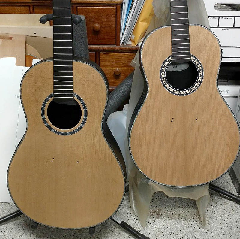

This project is a re-top of the two 5741 parlor guitars seen below.
The one on the right is Jonmark's and the one on the left is mine.
His will get torrefied Adirondack and mine will get torrefied Englemann. Both will be A-braced with torrefied Adi spruce.
Both will get shell purfling, his probably abalone and mine maybe black MOP. His will have tortoise-shell binding and I'm leaning toward black on mine. I was originally going to do cream, but I think the black will compliment the black MOP better.
His will have the standard 5741 rosette. Mine will have an inlaid Custom Balladeer rosette. Both are seen below.
Lastly, I'm thinking about glossing my neck/head stock. His will remain stock.

I started by removing the tops from both guitars.
That's when the fun began.
Ovation installed the purfling/binding in a non-standard way. Here's what the binding/purfling off these guitars looks like.
The problem is that they routed a slot that's deep enough for both the purfling and the binding. This leaves a full-depth groove in the body that's .125" (1/8") deep. The routed groove should only be .0625" (1/16") deep.
Here's what a standard binding/purfling groove should look like. The purfling is normally 1/2 the height of the binding, so a stair-step groove needs to be routed. As I noted above, the problem is that Ovation made the purfling the same height as the binding so the groove left behind is twice as deep as it needs to be. Ugh!
The simplest fix will be to glue some .060" thick purfling to raise up the inner portion of the groove so that it's level with the lining. Once these are glued and leveled, I'll be able to glue the top to the body which will overlap the filler purfling. This will allow me to route the top correctly later on.

I jointed both tops, routed them for the rosettes and glued the rosettes in yesterday. These are now ready to take to the wood shop and have them thickness sanded.
I still need to route the sound hole in my top. I didn't do it yet because I need to round the inner hole and I want to do that after the top is leveled.
I had to route out the hole on Jonmark's guitar because of how the rosette is glued to the top. Basically, it rests on a shelf instead of sitting in a groove like mine is, and like most guitar rosettes are inlaid.
It would have been extremely difficult to route out the sound hole after the rosette was glued in. In the pic below you can see the under side of the sound hole. The stock sound hole in the top is a little smaller than mine, but since the inner edge of the rosette is what defines the size of the sound hole, it won't alter the tone.
One of the tasks that needed addressing is the way these bodies were routed for binding/purfling. I talked about that about above so I won't belabor it here.
I glued the binding filler pieces today. Here's Jonmark's bowl with the filler pieces being glued into place.
Here's mine, all ready to have the top gluing surface sanded level.
This filler piece extends the glueing surface for the top and leaves a .060" shelf for the binding and purfling.

I got Jonmark's parlor top sanded, fit to the bowl and bridge located.
I got my parlor top sanded, fit to the bowl and bridge located. Unfortunately, I over-sanded the front of the top and burned through part of the rosette. Actually, all of the rosette, but the only part that is obliterated is the part next to the bass side of the fret board. Live and learn. Luckily, I sanded Jonmark's top second, so I knew to stop while I was ahead.
My top getting braced.
I'll pull this out of the gobar deck tomorrow, then epoxy on the aluminum reinforcement strips. I'll also glue down the braces to Jonmark's top and will be ready to start gluing tops Monday or Tuesday.
Jonmark,
On my guitar I'm moving the upper bout strap button from the bass bout to the treble bout. I've found it makes the guitar easier to play when standing up with a strap. Would you like me to move yours at the same time?
I'm planning to pull the old molly out and seal the old hole with epoxy. Then, drill a new hole on the treble bout and install a new molly. I'll texture the old hole during the finishing process.

DanSavage
Posted 2019-03-17 4:50 PM (#547398 - in reply to #546714)
Subject: RE: Dualing Parlors...
June 2012
Posts: 2351
Location: Pueblo West, CO
I got the purfling glued down to both guitars. Mine has black pearl and Jonmark's has abalone.
Purfling scraped down level with the tops.
Binding sized and glued into place. Mine has black and Jonmark's has tortoise shell.
I'll scrape these down tomorrow after the glue has dried. After that, I'll touch up the bowls, and then it's finishing time. (Yay!)

Love O Fair - 2019-03-17 9:11 PM
Not that I know squat.. but can you instead opt to scrape the purfling AFTER you set the binding so as to match flush with both the top and the binding edge, or is the binding edge too far below the scrape level of the top?
>>>and then it's finishing time<<<
Ah yes.. my favorite stage. Eastwood 2k on these??
The zipflex purfling is only .055" tall, so that's as deep as purfling channel can be routed. I've found it's better to have the top of the zipflex as close as possible to being flush with the top to minimize how much the shell needs to be scraped.
The BWB purfling is almost twice as deep, which means that about half of the BWB is above the top. This is too tall to get a good glue joint with the binding. So, the BWB needs to be scraped down before the binding is glued.
The binding is quite a bit taller that what is needed, so I use my Stewmac binding trimmer to get them close to flush. This minimizes the amount of scraping it needs.
Whether the purfling gets scraped to level with the top before the binding is glued or after, I've done it both ways. Plain purling is glued on at the same time as the binding, so they all get scraped at the same time. The zipflex has to be glued with CA, so the gluing technique is different.
Yes, these will be finished with Eastwood 2K.

DarenSavage
Posted 2019-03-22 5:45 AM (#547440 - in reply to #546714)
December 2016
Posts: 128
I mentioned to Dan it was hard to tell the difference between the abalone and black pearl binding in his earlier photos. Dan said it was because of the flash. He texted this flash-free photo. Youza!
Dueling Parlors they are!
Edited by DarenSavage 2019-03-22 5:49 AM

Both guitars' bowls are touched up, tops and necks are masked and ready for finish.
I'll be spraying the first coats in the morning.
DanSavage
Posted 2019-03-24 10:04 AM (#547454 - in reply to #546714)
June 2012
Posts: 2351
First coats of clear are on the tops.
The biggest take-away is the different personalities that are emerging.
Jonmark's top has really strong silking, which is surprising for Adirondack spruce. The top has as much sparkle as the abalone purfling. The rosette is brighter and bolder in person than what shows in the photo. This is definitely a stage guitar. It'll be very flashy.
Because of the close grain on my top its silking is much more delicate and subtle, which fits in with the subtle nature of the rosette and purfling.

2wheeldrummer - 2019-03-24 2:09 PM
Looking very awesome dan,does the difference in silking have anything to do with how old the trees are the tops came from.
Not really. What you're seeing is what's known as "medullary rays."
In short, these are the cells responsible for conducting sap through the cells of the tree.
These are most visible when the wood is perfectly with the grain perpendicular to the face. (quartersawn) As the cut gets more off being quartersawn, the medullary rays become less obvious.
Medullary rays are most noticeable in spruce, but are also present in other species of wood.
In the case of these two guitars, the Adi spruce has wider grain, so the medullary rays will be longer and stronger, visually. The opposite is true for the Englemann spruce. Tighter grain makes the medullary rays more delicate looking.

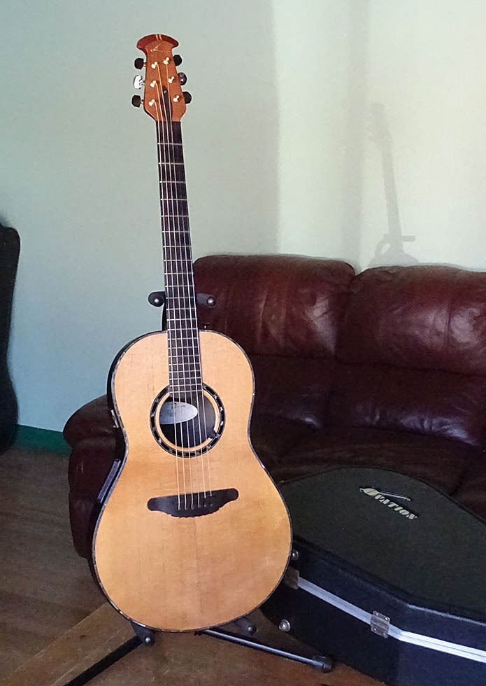

Here's the Q&D photo.

DanSavage
Posted 2019-04-13 6:22 PM (#547673 - in reply to #547670)
Subject: Re: Dualing Parlors...
June 2012
Posts: 2351
Ken,
Thanks! Sorry, no video today. Paul came over and played them -- loved them, but no video.
Bob,
Yes, the antique look is one of my favorite features of the torrefied wood tops. Well, that an the antique sound.
Kevin,
Thanks! Yes, I've become partial to it, too. I really liked the look of my I had my 2078T (Darth Ovation) along with the blacked-out look of the 2007 Collectors. In fact, the 2007C was a strong influence on this one. I originally put gold strap buttons on it when I put it together, but they looked out of place, so I replaced them with black ones. The black binding really makes the black MOP purfling pop.
Al,
Ha ha! Hence the thread title, 'Dualing Parlors.' Not so much identical twins any more as much as fraternal twins.
Sorry, no video today. I can say, and I know Paul will back me up, they both sound as spectacular as they look. Sound-wise, they are very similar with only very subtle differences. It would take a very good ear to be able to tell the difference between the two.
Jonmark's is slightly more resonant than mine. I attribute this more to the construction than the species of wood. When Ovation built Jonmark's they thinned the top quite a bit more than usual. As a result, when the neck got glued on, the fretboard extension is closer to the top. To keep from having to remove the neck and reset it, I had to eliminate the usual tapering I do when I thickness sand the tops.
Mine is tapered as usual, so it's slightly less resonant. As Paul said today, it'll be interesting to hear these guitars in a year or two. Even though the torrefied wood sounds (very) broken it, the wood continues to open up with age. It happens a lot faster than non-torrefied wood, but it still happens.
Jonmark,
Good eye. No, the compensated saddle I made is for the wide pick-up. (OCP-1K)
For some reason, when Ovation built these 5741 guitas, they used the slimline pick-ups, but used non-compensated saddles. I replaced yours with a compensated slimline saddle and the intonation is perfect. It plays in tune all the way up and down the neck. You're really going to like it. I put Elixer 80/20 Extra Light strings on both guitars.
I used the same Chicom undersaddle pick-up I put on my Frankenvation, then topped it with a Graphtech compensated black Tusq XL saddle. I also used the black Tusq nut on mine.
I've decided that one of my next 3D projects is to create a replacement compensated slimline saddle. Well, that and some preamp slider knobs. Mine was missing a couple of knobs, so I'm going to make some replacements. Once they're done, they'll go on my Shapeways page where anyone can buy them.
Speaking of Shapeways, they recently started offering very high-end, very rigid polyurethane and urethane methacrylate materials, so I ordered one of each. Once they get here, I'll put them on a couple of guitars to hear how they sound.

Congratulations on another superb project, Dan! Too bad you couldn't capture moody, p.i.'s session on video. I know you've already done plenty of torrefied videos; but if I may just say, from my spectator's perspective, one just never gets tired of hearing these torrefied treasures (figured, it never hurts to ask!). I'm just lucky I don't need a "video" to satisfy my thirst for torrefied resonance, cuz I got one of these baby's sittin' right in front of me!
moody, p.i. - 2019-04-13 11:03 AM
I played these today. Stunning...
Thanks for the succinct review, moody, p.i. always appreciate your perspective. Arigato!

Well, it's here, safe and sound. Probably no surprise here that Dan is as meticulous in packaging as he is at building.
Top is beautiful. As he said, pictures don't do justice. How does it sound?
Loud.
Ballanced.
Warm.
I'll get around to some audio clips.
Really impressed... both by Dan's work... and the torrefied top.
Did I say it was loud? Big voice for a small salad bowl.

I found this pearl of a guitar under my tree Christmas morning. Lucky me!
I've renamed it Black Pearl Parlor. Dan and I played together with his Black Pearl guitar. They sound great together. Sadly, no video/audio; you have to take our word for it.
Black Pearl Parlor

It looks like someone was a good boy this year.

Congratulations! I suppose Santa doesn't do photo narrations on some of his luthier jobs so as not to blow the surprise element for the good boys on his list ;-)
