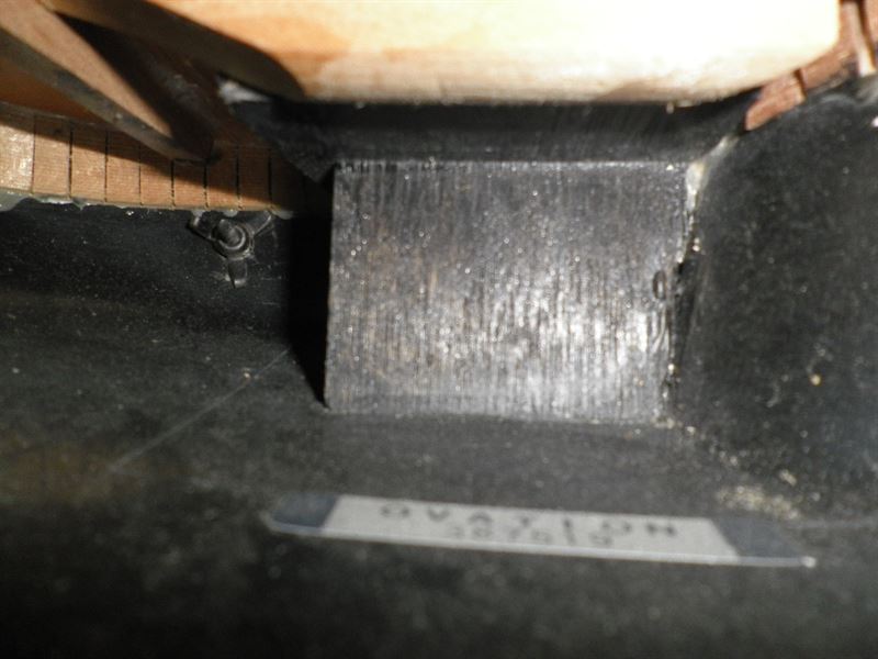

Posted 2021-01-31 3:47 PM (#554976 - in reply to #554969)
Subject: Re: Guidance on a Bowl Bend on a 1974 Custom Balladeer
Posts: 584
Location: Denmark
DanSavage - 2021-01-30 1:30 AM
... You can easily tell a hand-laid epoxy bowl from an SMC by looking at the neck block area. If it's got a wood block, it's epoxy. If it's got thin buttresses instead of wood, it's SMC.
Like this?
Also I guess that we are talking Fahrenheit degrees.
Edited by tpa 2021-01-31 3:50 PM
DanSavage
Posted 2021-01-31 5:05 PM (#554977 - in reply to #554934)
Subject: RE: Guidance on a Bowl Bend on a 1974 Custom Balladeer
June 2012
Posts: 2347
Location: Pueblo West, CO
Yep.
Here's a SMC bowl for comparison.
Some models of Ovations used SMC bowls, but glued on the necks, such as the 1624 and Parlors.
Yes, Fahrenheit.
