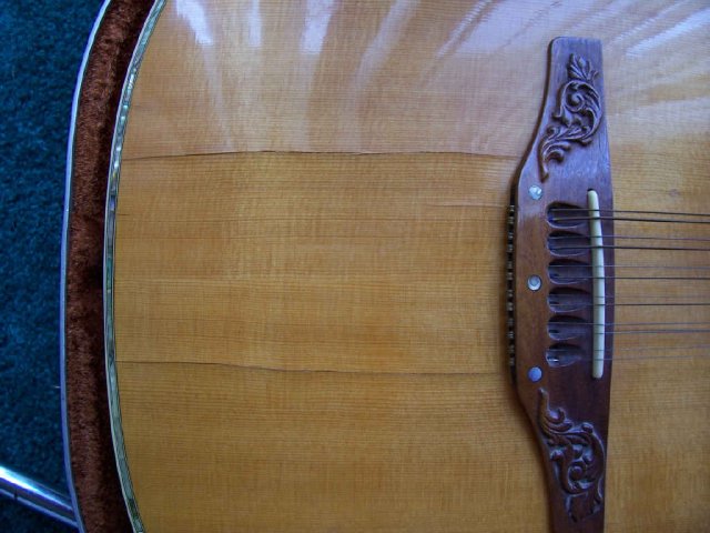

Location: SoCal | just got a picture from seller...major cracks, email if you want a pic.
would recommend having it sent direct from seller to factory. |

just got a picture from seller...major cracks, email if you want a pic. yeah, I got it too... ouchie. They can fix that? |

Location: closely held secret | Looks like a third crack is starting at the bridge, which looks like it could let go any time...

Location: Lake Hiawatha, New Jersey | Oh Man, what a mess! I'm not an expert, but it looks like the whole top needs to be replaced. It looks pretty buckled as well as cracked. |

Location: SoCal | I AM NOT AN EXPERT...although I have been successful...
Sure, this can be fixed...either have it sent direct to factory from seller or do it yourself.
Two choices:
Full top refinish (down to wood) which was about $350-375 for my CL 1658 (a/e version of this) plus factory shipping to me.
Or, have factory seal, sand, and buff for pocket change.
Or (in addition to checking braces), seal, sand and buff using material from Stew/Mac.
Was told (and agree) that natural is easier than dark sunburst - repaired a bad finish crack in dark sunburst that is smooth, hard to see. On this, even if the crack is visible, will look more like the grain.
Here's the deal...if anyone from OFC is going to bid, let me know. These are hard to come by and the best wood-top 12 that I have ever had or played. I wouldn't sell my natural 1658 for less than $1,200. So, if it will go too low, I will get it, send to Kim (sorry Kim, know everyone is busy), full top refinish, then sell it for big bucks. I would easily pay at least $350-400 for it. However, I have two 1658's - would rather someone on the OFC get a fine instrument.
You want an a/e 1658 or a 1659 non slothead - both dark sunburst that I might sell (stacked tone/vol) - suggest that this one be left acoustic. |

Location: NJ | That needs a new top. |

Location: Warren,Pa. | If what Cliff says is true...that the top needs to be replaced (a judgement call, but I tend to agree), then you have to take into account that when the boys at the factory replace a top, they also replace the bowl and the bridge. They take a band saw to it and cut off everything a couple of inches from the neck. Then they unbolt the remains and rebuild. So...you're essentially bidding on a neck. It is a beautiful neck, though. My point is that you kind of wind up with a different guitar. |

Location: SoCal | bridge does not appear to be lifting (also confirmed by seller) and other "stress" finish cracks that would indicate top replacement...of course, only the factory would be able to make that judgement (and they are on a vacation break).
it is a risk but if, as the seller has stated, there are no playability problems (bridge, neck, etc.) then pretty good chance the cracks just need to be sealed. this will never be cosmetically perfect but should be able to get the finish cracks smooth and look close to the grain. note that the finish cracks are not into the inlaid...heck, the custom elite I just bought has a finish crack into the inlaid.
the cracks look bad because they are old with oil, dirt, whatever that has gotten in there. if one of the cracks is through the wood, seal the bottom as you are sealing the top. again, these do not look like fresh cracks so at least you know what you've got.
fill, sand, buff...a good home project. |
