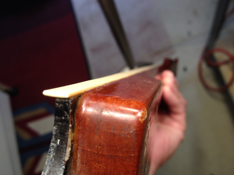

This first photo shows the condition of the original binding. The top edge of the binding was well worn, leaving no shelf for the frets, thus the last frets to be installed were shortened to just the edge of the wood.

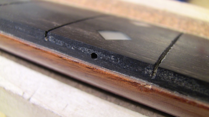

Once the binding is pulled, clean off all the glue from the wood. Acetone will dissolve the original glue. I carefully and gently used a chisel to by hand scrape away some of the larger globs of glue.
Here is an edge after the glue was removed. One of the drill holes from an original side dot is visible. Also note a chip-out of the gloss coat by the fret slot. That kind of damage is difficult to get really smooth once the new binding is installed, and is why careful scoring of the finish before removing the original binding is key.

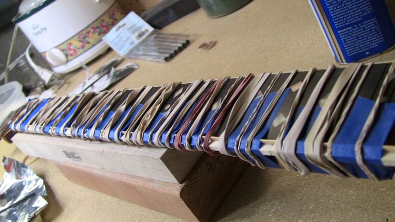

Installing the new binding is not terribly difficult, just a bit fiddling to get it right and do it quickly. But before you install the new binding you will want to sand the fretboard. See the thread on refretting for details.

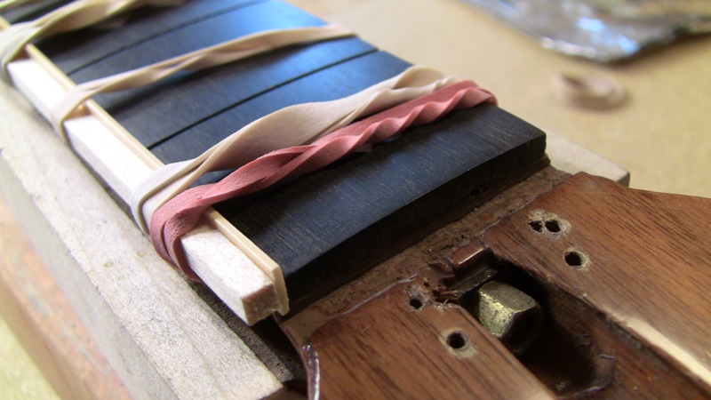

The treble side binding has no dots and was installed in one frantic glue operation. By doing it this way I was able to get the entire length correctly positioned. But the glue was not strong in a few spots which required Acetone be wicked into the glue joint to reactivate the glue. Overall I don't recommend attempting to glue it all in one go. Leave a little extra length at both ends. It is very easy to trim after it is glued.

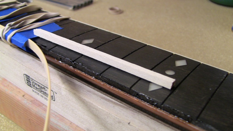

Because the new binding is taller than the top of the fretboard, taping or rubber banding it would tend to tilt it. So I used a length of square wood to press down along the glue joint to keep it in place. Lots of rubber bands!
StewMac sells a length of rubber band material for binding which would be a big help compared to what I did. Our grocery store sells large rubber bands for kitchen garbage cans which are cheaper than the StewMac but shorter.

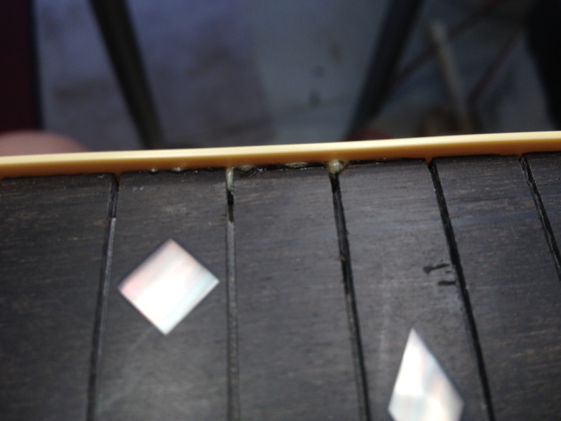

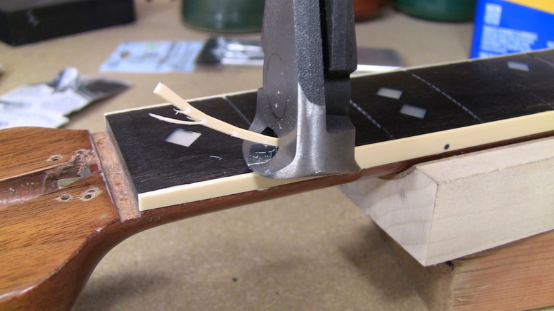

After letting the glue dry overnight this is how it looks. There is squeeze-out of melted plastic but it cleans up very easily with a scraper or sandpaper. Here you can see how the binding is taller than the fretboard and there is some extra length hanging into the nut area. Yeah, you'll have to remove the nut and probably make a new one to match the new frets.
Squeeze-out into the fret slots easily comes out using a fret slot cleaning tool. Glue on top of the fretboard is easily removed when sanding the new binding flush with the top of the fretboard.

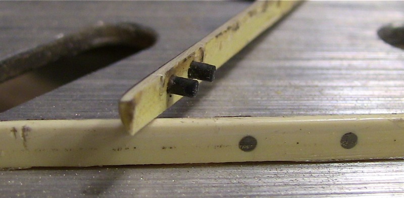

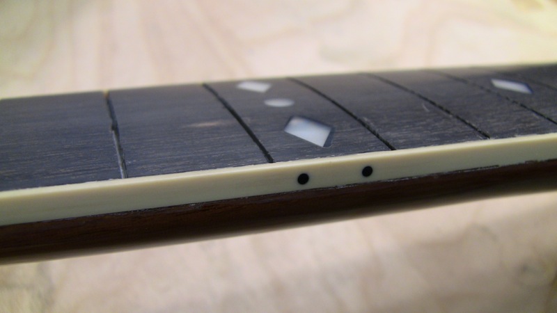

Installing side dots is easy once you figure out a method. I made a fence for my dremel drill press. Each dot is drilled the exact same distance from the edge of the binding. The location is carefully marked onto the binding by using the existing holes in the side of the fretboard. Use the smallest diameter side dot rod you can buy. Put the rod into the hole, nip it off with the fret cutters (or any good flush cutting tool). Then apply a small drop of thin super glue to both sides. Once all the dots are glued in, trim off the excess glue and dot material. There are several methods. I found the best for me was to put a fret leveling file in a vise then pull the binding across it. StewMac has some videos.
To glue the bass side binding on I decided to glue in segments, about 4" long each. That's one long piece of binding, glued 4" at a time. Not multiple short pieces of binding! First I placed the old nut as a positioner for the binding. On this side because of measuring for the side dots I couldn't have excess length at the nut end.
This shows one section already glued on, taped, and banded. The next section has glue already applied. The square stick is sitting on the fretboard ready to be put in place for taping.
Here's the whole length taped and bound.

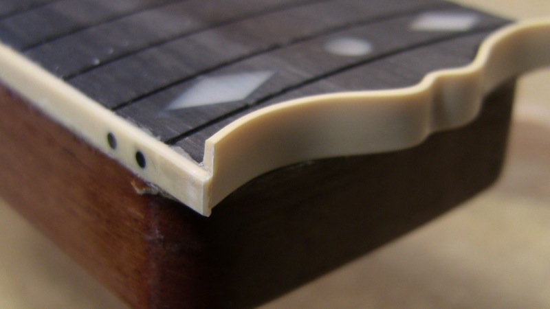

Once the glue is dried, trim off the excess height using fret cutters or any good flush cutting tool. Then use a file to get close to the wood, being careful not to damage the wood. Use a radius block (ideal) or a plain flat sanding block with 320 grit sand paper to get the binding right down to the wood. Finally, use finer sandpaper to get a smooth top surface on the binding. Clean up any minor scratches in the fretboard.
Along the bottom edge of this new binding you can see the uneven edge of the clear coat. It can be filled in with thin super glue. I wiped it down several times with acetone to smooth out the super glue. It worked ok but not great. Simulating playing with my left hand, it feels pretty smooth. I want to work more on these transitions from the old clear coat to the new binding.

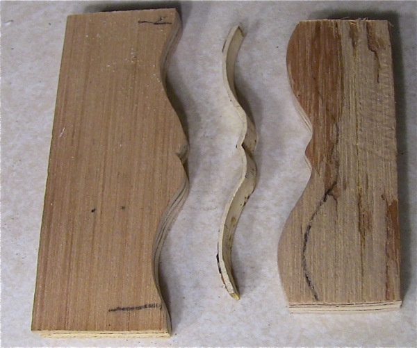

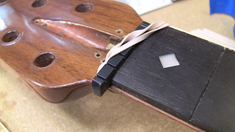

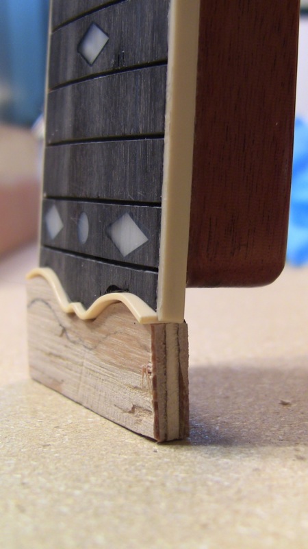

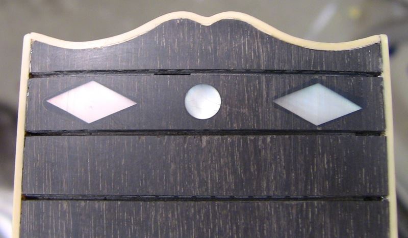

Replicating the mustache at the end of the fretboard was a bit of a frustration. I made a simple jig to bend the molding. Dan Savage made a much better jig which held itself in alignment. Still, this one worked even if it caused a few 4 letter words! I traced the shape of the end of the fretboard, and carefully cut it using a scroll saw. It took a couple of tries to get a good smooth shape which matched properly. Then a heat gun was used to soften the binding and pressed between the two halves of the jig. A heated metal press would be far superior!
This is the old mustache and the jig.

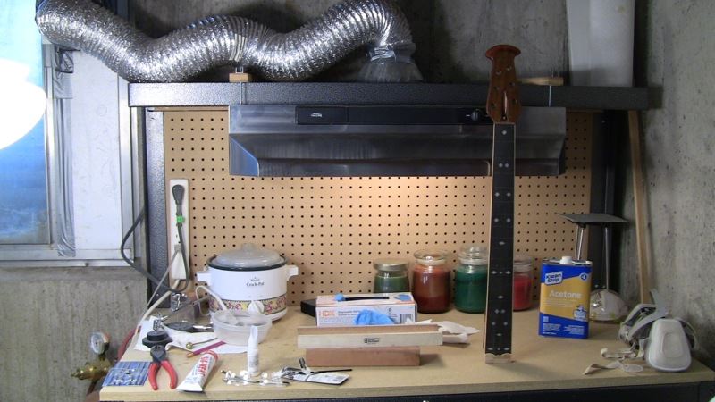

To glue the new piece on, I used one half of the jig and stood the neck up on end to apply pressure. It worked great. The workspace is my wife's jewelry bench with a ventilated hood. These glues and solvents are hazardous, so wear a respirator and ventilate the area.
The extra height of the binding is nipped off and then sanded down flush. Acetone can be wicked into the joints between the pieces to fuse them together.

My first attempt at making a mold for the moustache binding was just two pieces of wood, like what you made. After a few attempts and choice words, I decided to make one side fixed and the other one sliding. I did this mainly to be able to get the clamps into place before the plastic cooled down.
Your mousetache trim turned out great! It looks like a factory job, which is saying a lot.

For the mustache I made several molds before getting a good one. Your jig with one end secured is a lot better than mine. Ideally a multi-piece mold would work better to get the center point sharper. The next time around I'll experiment with one mold to make just the center crease, and then a second mold to do the entire mustache.
