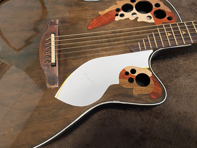

I've really been enjoying playing this 1868 (while neglecting my 1115 project for a week or so), and noticed that the nitrocellulose finish scratches easily when compared to a poly finish so I decided to make a clear pickguard for her. Started with a few mock ups loosely based on the Adamas 1581 pickguard...
mock 1 & 2
mock 3
Decided to go with mock-up #2...
final mock
Hmmm... Yup, I like it. Feels good to have that protection...
Pickguard done
The pickguard is thin and does not hinder the guitar's voice and it's transparent nature keeps the cosmetic beauty of the Elite intact! Also, fairly easy to remove with the heat of a hair dryer. Highly recommended! Now, just gotta wait for the caps to arrive! Oh yeah, can't forget to finish the 1115! Thanks for letting me share OFC/BFLG!
