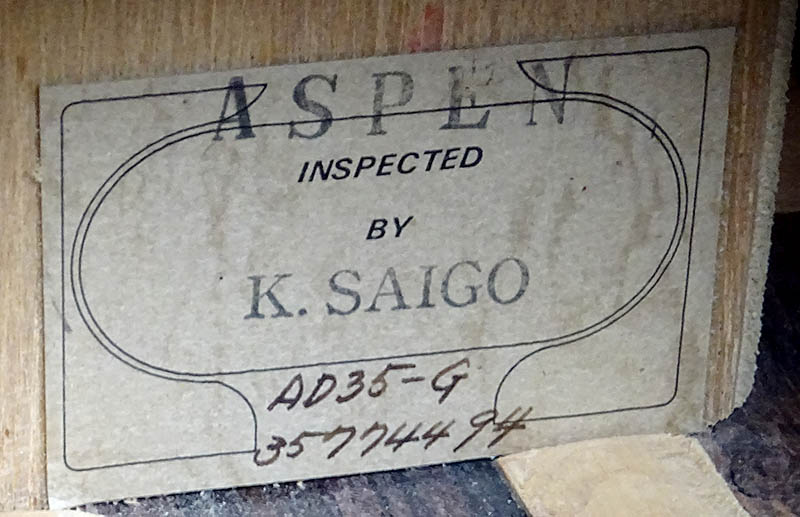

WRT the Aspen serial numbers, as I recall, the first two digits are the model and the next two digits are the year it was made.

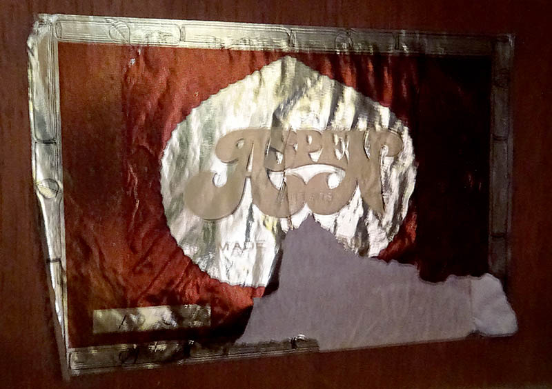

I checked the labels, and found that the AD35 is a 1977 model, and the AD18 is unknown due to my teenage Coke sticker that tore off the part of the label with the serial number.

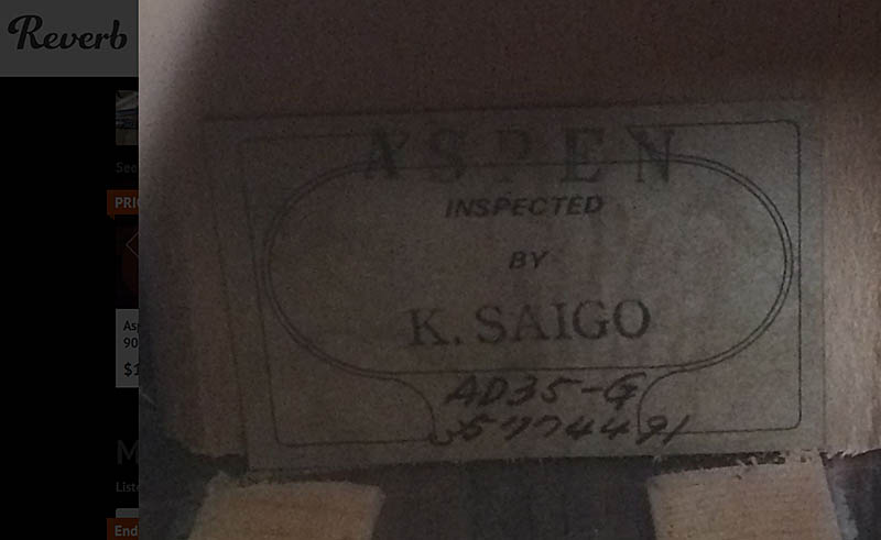

I just did a quick search for Aspen AD35-G and came up with this Reverb ad. What's interesting is that it's serial number lists it as 3 guitars from mine. Mine is 4494, this is 4491.
1977 Aspen AD35-G ad
After more searching, I found that the previous Aspen I pointed out was an AD28. Sort of a half-way between the AD18 and AD35. Not sure what the G stands for.

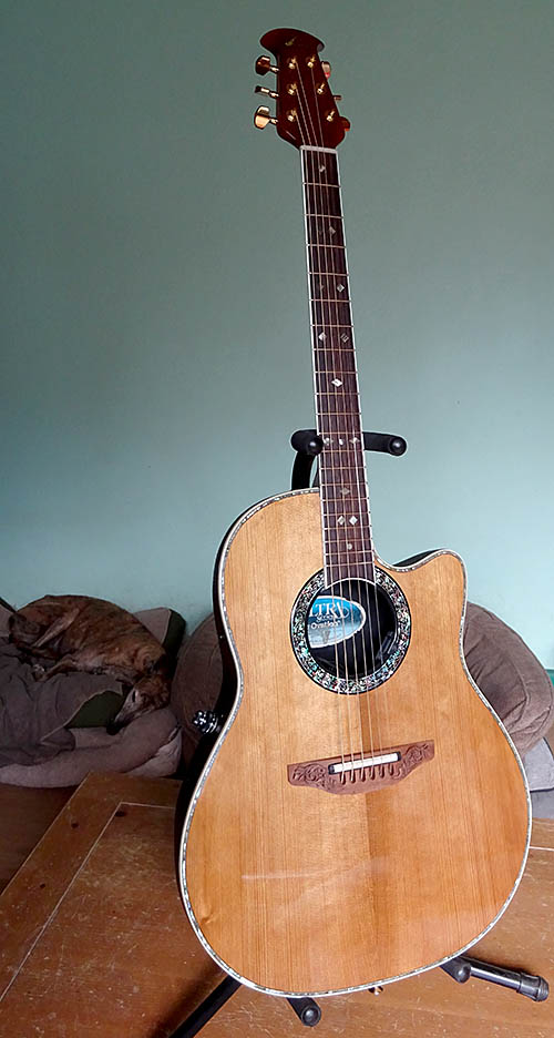

Let's get this back on Ovations!
I picked up the Custom Ultra again and it was like coming home. So nice it put the dog to sleep (not really, she's always like this).

Daren.. I'm developing a real crush on that guitar (the Ultra) since I first saw and heard it in your video. And I totally agree on the "coming home" part since I always feel that same way after playing another brand and style. Kind of like crawling back into your own bed after being on the road, no matter how nice the hotels were.

+1
...man, I know I've said it before, but that Custom Ultra is drop-dead to the floor, beautiful! Stunning!

Whoa! That's cool. What would be the odds that your guitar's sibling is up for sale.
I just checked again and that AD35 on Reverb is sold. (Actually it was sold on 4/11/2017)

@aumako - "that Custom Ultra is drop-dead to the floor"
Yeah.. that's obviously what Daren's dog Greta was thinking right before that last picture was taken. I just now went back and reviewed the rebuild process photos and it is once again affirmed that Dan truly is a master at his his craft!

Yep. That's a real purdy guitar.
