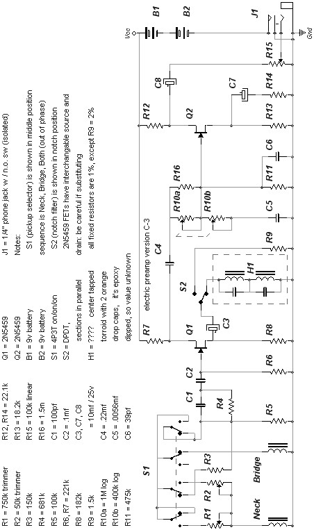

Here's a link to a page that explains how the preamp works: http://www.ovationtribute.com/Catalogues/Breadwinner%20Settings%20M...
It's not worthwhile for the average person to try to make an exact copy of the original preamps. They used some custom-made parts that aren't available anywhere I've looked. But here are some schematics from OFC member BruDev:
http://www.ovationfanclub.com/photos/BruDev_63029_c-2.jpg
http://www.ovationfanclub.com/photos/BruDev_63084_c-3.jpg
http://www.ovationfanclub.com/photos/BruDev_63139_d.jpg
http://www.ovationfanclub.com/photos/BruDev_63183_e.jpg
http://www.ovationfanclub.com/photos/BruDev_63233_f.jpg
The last two schematics on this page are for Breadwinners: http://www.doremi.co.uk/breadwinner/circuits.html
The second one from the top is for a UKII and was posted on the Breadwinner page by mistake.
If you want to duplicate the action of the Breadwinner preamp, you need an active bass/treble "tilt" control on a single knob, a volume boost ganged to the pickup switch when both pickups are selected in parallel and out of phase, and a midrange notch filter switch with volume boost. I can imagine several ways to get close to this but don't have any specific suggestions. It would be pretty easy to build a preamp with conventional volume and tone controls and maybe a treble boost in place of the notch filter switch. Or you could try one of the Artec preamps that are commonly available on eBay.
