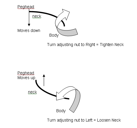

| Tim in Yucaipa |
Joined: August 2003 Posts: 2246 Location: Yucaipa, California | Pier, this might help: ![]() | ||
| 2ifbyC |
| Joined: December 2006 Posts: 6268 Location: Florida Central Gulf Coast | Tim, I love this diagram. I remember you said it wasn't quite right when you first posted it. Is this what you were looking for? ![]() | ||

| Tim in Yucaipa |
Joined: August 2003 Posts: 2246 Location: Yucaipa, California | iffy, The thing that bothers me is that I don't have a correct "righty" arrow. I like your version, but would like it to be the same as the "lefty" only mirrored. That's something I cannot do with the setup I have here at work... Also, please ANYONE, feel free to "tinker" with this diagram to suit.... it's only a visual intended to help others.... ;) | ||

| G8r |
Joined: November 2006 Posts: 3969 | Originally posted by 2ifbyC: This any better? Tim, I love this diagram. I remember you said it wasn't quite right when you first posted it. ![]() | ||
| 2ifbyC |
| Joined: December 2006 Posts: 6268 Location: Florida Central Gulf Coast | Bingo Serge! By Jove, I think you've got it... ![]() | ||
| Tim in Yucaipa |
Joined: August 2003 Posts: 2246 Location: Yucaipa, California | Spot on! Great Job!! Now I can retire my hackneyed attempt! Very Cool! | ||

| G8r |
Joined: November 2006 Posts: 3969 | Up on ning: ![]() | ||
