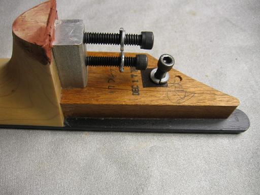

Whoa Now!... If this is a 2078T contour bowl, it should have a TRC like this...
If for some very weird reason it does not, and the adjustment in inside the bowl, and it has a Kaman Bar... Make sure you adjust the allen bolt for the truss-rod. If you adjust one of the bolts this hold the neck on, you get This!

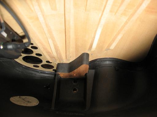

Posted 2008-09-01 3:47 PM (#22875 - in reply to #22862)
Subject: Re: Tension Rod question
Originally posted by FlySig:
My daughter's 2078T (all black, not the Sweetwater T), has the truss rod cover on the headstock. The neck is the same all maple T neck that is on her sister's 1778T, also with the truss rod accessed at the headstock.
I hope my photo does not confuse anyone.
The Sweet T is just a 2078T with no special designation on the sticker.
They just grabbed some 2078T's off of the line and routed in the Koa.

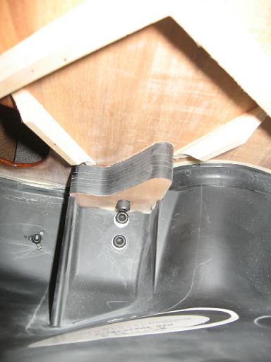

Posted 2008-09-01 10:13 PM (#22876 - in reply to #22862)
Here is the innerds of a 1778T and a Koa 14 fret.
Not all ANS necks have dual Truss Rods or they buried them. Bolt ons are the way to go though.
Posted 2008-09-01 10:14 PM (#22877 - in reply to #22862)
Also note that some of the rock Maple necks tend to split at the base of the heel.
That's why I'm plastering this one.
So that explains the bolt Para'niay describes but, not why he can't find, what I think would be very obvious, the bolt end under the TRC...
I suspect alcohol is involved.
But what does that perpendicular bolt do? The other two obviously attach the neck to the body. Does this align with a guiding hole in the top of the guitar?
Thanks for all the pictures guys, it makes it a lot clearer.

"But what does that perpendicular bolt do?"
It keeps the end of the Fretboard from "humping".
