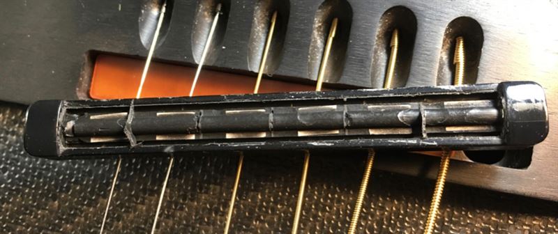

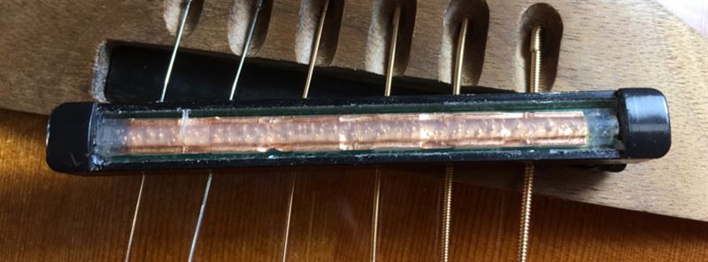

Good results so far with replacement saddles. Peeling off the original plastic saddle really is easy, and the new saddle completely solves the low E intonation problem.
1) No discernible tonal difference with the white saddle in the 1537 compared to the factory original. It dropped right in easily after removing the original saddle.
2) The stereo pickup in the 1537 has an interestingly different construction with copper tape along the top surface rather than soldered wires. Being stereo, there must be 2 wires on the bottom of the piezos. This is a late Fender era replacement, not the 1983 original.
http://www.ovationfanclub.com/megabbs/photos/get-photo.asp?photoid=...
3) The black replacement saddle for the 2080 is not sitting totally flush at the 6th string. The saddle is .011" longer than the original, and there is an excess of RTV/silicone inside the pickup. With some filing of the saddle and trimming of the silicone it fits laterally but is still not flush at the 6th string. I believe there is still some excess silicone, and possibly the silicone is off center along the piezos. It trims off very easily with an X-Acto knife. Acoustically it sounds normal but plugged in there is almost no signal from the low E string. With a bit more careful trimming of the silicone I think this is going to work fine.
4) I would love to have an off-white color that looks like unbleached aged bone rather than the bright white.
5) When retuning the strings, eyeball their position carefully over the new saddle so that they are properly spaced. Once up to pitch they will create a small notch in the saddle, so spend the few seconds to get it right.
6) Someday I'll figure out how to post pictures on this forum so that they display. Jeez.
http://www.ovationfanclub.com/megabbs/photos/get-photo.asp?photoid=7282
That's interesting. I've never seen the inside of a stereo pickup.
http://www.ovationfanclub.com/megabbs/photos/get-photo.asp?photoid=7283
http://www.ovationfanclub.com/megabbs/photos/get-photo.asp?photoid=7284
Have you been able to compare the old saddle to the new one to determine if they are identical? How does the old one fit into the pick-up?
Given that the new one shares idential dimensions with the OEM, there must be a reason why it's not settling into place.

The length of the new saddle is .011" longer than the OEM saddle. Upon first installation it bowed upwards because it was too short for the available space. The OEM white saddle from the 1537 is the same length as the black saddle from the 2080. There was definitely a lot of silicone inside the pickup assembly, including at the ends. Even with trimming it out, the saddle was still just a titch too long. It was easy enough to file a little off of the ends.
However, the front edge at the 6th string is still sitting proud. I expect the problem is too much silicone inside the pickup assembly. The cavity is totally full of the stuff. The bead across the low E piezo crystal appears a bit crooked by eyeball. Later today I will take it apart and carefully remove more silicone as well as compare the two saddles.
New saddle on top, OEM saddle below. The right edge of each is against a straight edge.
Thanks for the help with photos. This forum is the only space I have difficulty posting photos on.

That's weird. I just checked my black saddles and they're the exact same length as the OEM saddle.
For your black one, make sure to sand a little off each end so the slots are between the piezo crystals.
Looking at the inside of the pick-up a couple of the piezos are crooked and the low-E looks like it might be off-center. Even so, this shouldn't prevent the saddle from fully seating.
The amount of silicone looks normal.
Is the profile (cross-section) the same between the OEM and new saddle? Specifically the low-E.
Try putting the saddle in backwards to see if the problem is with the saddle or the pick-up.

FlySig,
Do me a favor. Compare the length of the black and white saddles and let me know if the black is longer than the white.
Even though the black will be shorter than the white because it's been sanded, the slots on both should all line up.
If Shapeways is sending out different size parts, I'd like to know that so that I can address it with their tech support.
FlySig
Posted 2019-02-10 4:21 PM (#546986 - in reply to #537044)
Subject: Re: How To: Replace OCP-1K Bridge Saddle...
Posts: 4090
Location: Utah
By eyeball I can't see any difference in the length of the new black vs new white as they are installed by comparing them to an old saddle held next to them. Not very precise. I can pull the saddles off at the next string change which will be next week or so. The new black saddle measured out at 1.766", whereas the original black saddle was 1.755". I did not measure the new white saddle before installation.
The inside distance between endcaps on the saddle assembly is quite different between the two guitars. The black one on the Adamas (2008) is right around 1.763", whereas the white one on the 1537 (stereo, 2014) is 1.785". I can imagine the assembly process results in a lot of variation in that dimension.
The black saddle assembly was chock full of silicone. Squeeze out filled every spare space. With some careful scraping and picking out, the new saddle now sits flush and works perfectly. It did need to be shortened ever so slightly initially, but the dead low E piezo was due to all the silicone inside the assembly. There was quite a bit down in the longitudinal channels that could have been jacking the new saddle up, or it could have been the center ridge of material on top of the piezos being too tall. The material was very easy to trim out with an X-Acto knife and good lighting.

Phew! I'm really happy to hear that you got it working on your 2080.
WRT your measurements, I'm sure you mean 2.### and not 1.### as the 3D printed saddles are, as designed, 2.75" long.
I've got 3 black saddles installed. I ordered the first one with the white one I antiqued. Then, I ordered two more black ones on a separate order.
I measured the saddles and the space between the pick-ups using my digital calipers.
Saddles: 2 - 2.75", 1 - 2.76"
Pick-ups: 2 - 2.78", 1 - 2.8"
I also tested three different spare pick-ups and the space between the end pins was 2.78". I'm sure I could keep testing guitars, but I would probably find that these are all about the same distance.
It looks like the black saddle you ordered was probably marginally larger, like one of mine. But, your space between the end pins on the pick-up was the same distance, which explains the interference fit on length.
You're the first one who's reported a problem with the saddle being too long. Those who have got theirs report that it just drops right in.
I'm just glad you were able to make it work without too much hassle.
