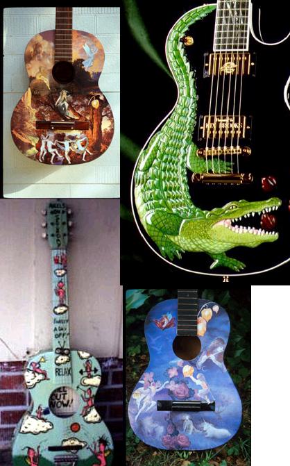

While we're on this topic, I've been pondering the possibility of re-doing the top on my Ultra 12-string. It's my beach/boat/knockaround guitar, so I was thinking of doing a bit of a funky, "nautical" paint job, possibly with some gold leaf . . .
What's involved with removing the rosette??
(I was considering doing the rosette pattern around the soundhole in goldleaf . . )
What grit sandpaper is recommended to remove the finish?? It's black now, and I don't need to take it down to bare wood for any kind of transparent finish - I just wanna have a nice, flat, clean "canvas" to work on . . .
Any advice??
Posted 2005-01-19 7:59 AM (#166070 - in reply to #166066)
Subject: Re: Removing Polyester Gloss Finish ???
Hey Cliff, who am I to be giving YOU artistic advice ... but if it were me I would paint some palm trees on it.
Posted 2005-01-19 8:04 AM (#166071 - in reply to #166066)
I'm thinkin' "Pirate"
". . . harrrgh! . . ."

You know Cliff - if you worked in Latex or Tempora it would be a replacable artwork!

Yeah I know, Woodster . . but if I go with the goldleaf, it's gonna need a protective varnish over it once it's burnished . . . besides, it'll be subjected to a lot of outdoor abuse, so it'll need a degree of permanence/protection . . .

Just glue some starfish and seashells to it...

don't laugh . . .

RE: "don't laugh"
