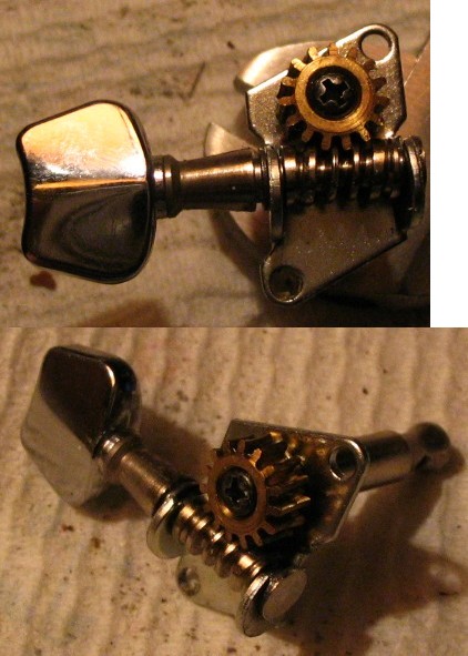

Joined: January 2003 Posts: 1498 Location: San Bernardino, California | The screw that holds the gear to the shaft might be loose. Here's a picture of an el-cheapie tuner to show what I mean: ![]() If you want to try to fix it yourself, you will have to get the round cap off the back of the tuner. Sometimes if the screw is loose enough all you have to do is tap the top of the shaft and the cap will pop off. Don't hit it too hard. If you can't the cap off that way it's probably better to replace the tuner. | ||

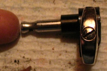

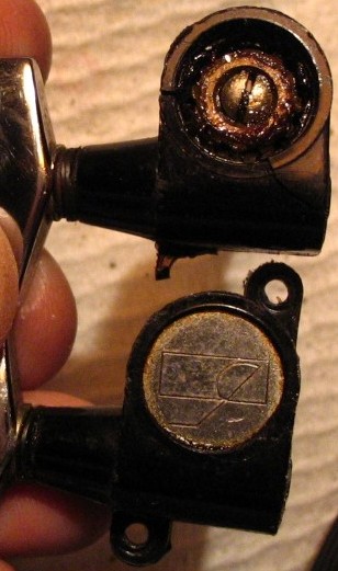

Joined: January 2003 Posts: 1498 Location: San Bernardino, California | This photo shows a (broken) tuner with the rear cap off: ![]() The all metal tuners are built in the same way. Although some have a 'D' shaped cap. and this photo shows my finger pointing to the shaft to tap: ![]() DON'T TAP IT HARD. If you do it will damage the tuner. Most of the time that I've seen a tuner slipping it's been the screw holding the gear to the string shaft that's gotten loose and allowing the gear to tilt. | ||
