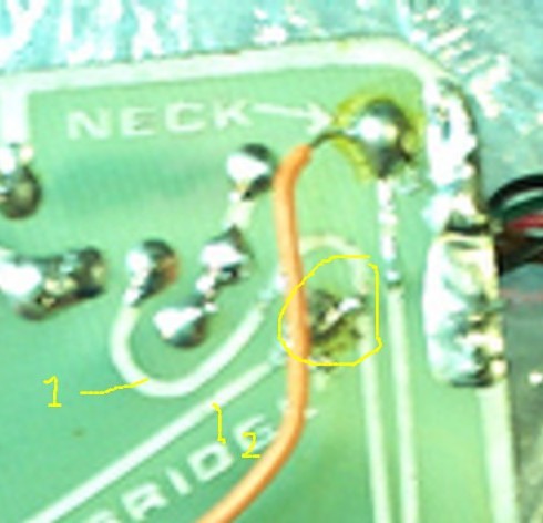

I just purchased a Breadwinner from craigslist here in Austin. I could not believe my eyes when I saw that posting. I have been looking for one of these guitars for a while and suddenly there it was, I had to get it.
Anyway, although the guitar is in great shape, I am having trouble with the electronics. The tone knob doesn't seem to do anything and the Notch filter switch just makes signal even weaker than it already is. I took the electronic board out and it looks like there was a modification made to it. There are a cople of extra wires that I don't think are original but it looks like they have been there a long time. I took a picture it is here...
http://www.flickr.com/photos/13965576@N00/275496622/
Any help in figuring this out would be great. I have the schematic from the breadwinner fan page and I am slowly going through the circuit now, but any help you guys can offer would be great. thanks
Julio
Posted 2006-10-21 4:13 PM (#235359 - in reply to #235358)
Subject: Re: Breadwinner Electronics help...
Posts: 7251
Basically they bypassed the pre-amp, sortof.. Remove those two jumper wires. They don't belong. Someone may have just done this to bypass the pre-amp without destroying it, so just remove them and see if the pre-amp works. And remember the selector switch is BOTH-Bridge-Neck not the normal Bridge-BOTH-Neck.

BruDeV
Posted 2006-10-21 10:17 PM (#235361 - in reply to #235358)
January 2003
Posts: 1498
Almost looks like traces 1 & 2 are shorted in the circled area. Make sure they are not.
baconJuice
Posted 2006-10-22 1:28 PM (#235362 - in reply to #235358)
Posts: 7
Location: Austin, Texas
Good eye BruDeV! That connection was indeed bridged and I fixed it, unfortunately, the pre-amp still does not work. I guess that is why it was being bypassed. :( I'm sure it is fixable, it's just going to take some time to go through the board find the problem. oh well, back to the bench it goes.
