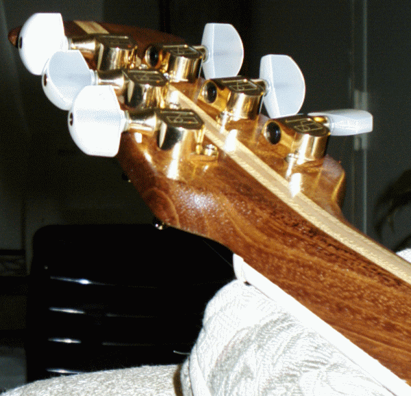

This is 12 coats of Tru-Oil. Maple in the skunk stripe. There is a very slight amber tone in the maple.
Cannot say enough about how much I love the feel of this finish on a neck.
Not for everyone I know, but it's pretty and tough.
As always, apologies for the lousy camera.

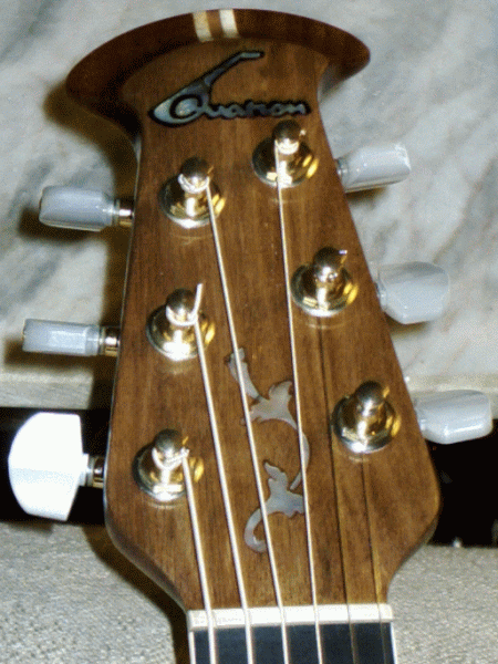

Just for reference, this headstock has a Tru-Oil finish with a nitro overspray.

Wow, that is incredible. I've never seen definition like that on an Ovation neck before. What model did you start with for that refinish?

It's a mixed Legend. Nutmeg AAA top, brown artist depth cutaway bowl, standard Legend top binding and uncarved bridge (with vine inlay's), Custom legend fretboard and rosette.
I had it built in '82.
Kim and I recently went back and forth trying to relabel this. I finally decided to make my own and call it a Franken Legend. I had an album posted on the ning site... until I accidentally deleted my account there. Just haven't had the chance to rebuild it yet.
Very nice piece of mahogany in the neck but, as I mentioned, the oil finish brings out figuring depth unlike overspraying. It builds the finish from the inside out instead of from the surface up.

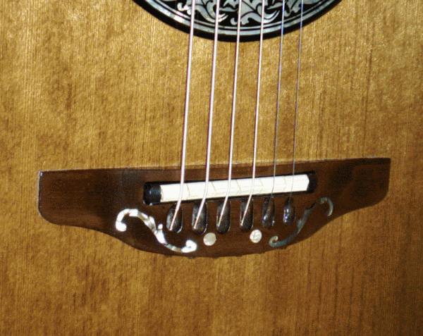

Mike Lennon. Ran the Apprentice Shop in Spring Hill Tennessee until a Saturn plant gobbled up the small town. Very talented guy.
Here's his inlay work on the bridge.
