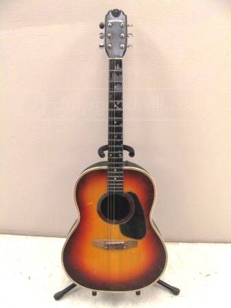

Goodwill Auctions have 2 deep bowl Applause cheap
There imported Hamer for $8

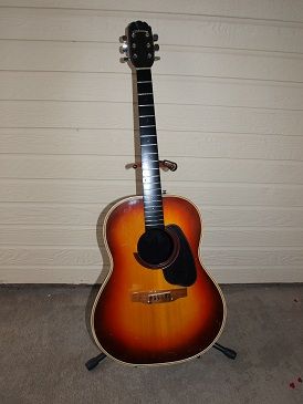

It's OK. Usual wear on the "first- four". Have to repair the cracked bum, around the end peg. Top isn't too bad. No major cracks. Date under the fretboard extention says "FEB 5 1976". Bowl will have to be resurfaced/refinished, after the bowl repair. Bridge is in good shape. No tags or labels, but it definitely is an AA-14, with the broccoli head. Have to decide what to do with the rosette- only half of it exists.
Anywho, the BFLG is active in this quarter!

I have repaired the cracks around the end-peg with some JB Weld, and sanded it out. I am attempting to restore the pebblegrain pattern with some clabbered polyurethane varnish, and some judicious use of an old toothbrush. We shall see how that turns out, after I reshoot some matte-black paint on the bowl.
I am closely assessing whether there is enough of the fretridges left to relevel the tops. Otherwise, I think I will grind them off, and reslot the fretboard, to glue in some new fretwires. Really, got nothin' to lose with the releveling scenario.
Since the bowl has an output jack hole already, I figure I will install one of my FET preamps I built, awhile ago.
Damn the torpedoes!

OK, so here are some shots of the project. Cleaned up pretty well, really!
