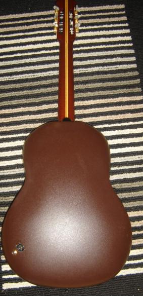

Hi
Can anyone help with cutting templates for retro fitting of Op PreAmps?
Bit reluctant to put the saw to the bowl relying on my own home grown one.
Paul

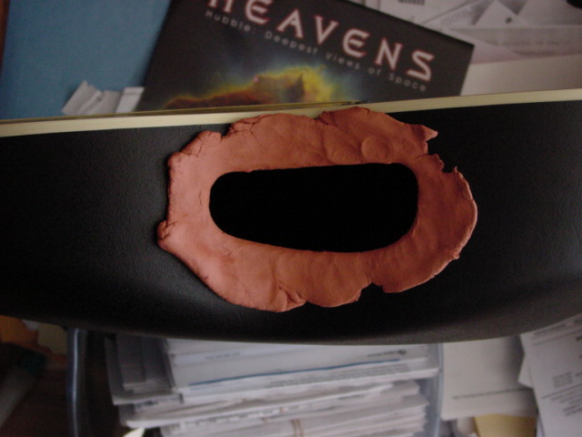

Paul - I have done this before on two guitars. I made a template out of modeling clay using a guitar that already had the OpPro installed:
Having the properly contoured template allowed me to find the right location to cut the hole. I used a combination of a roto-zip and sandpaper. Once you have the rough hole cut, it's pretty easy to shape with sandpaper - or a dremel with a sanding bit.

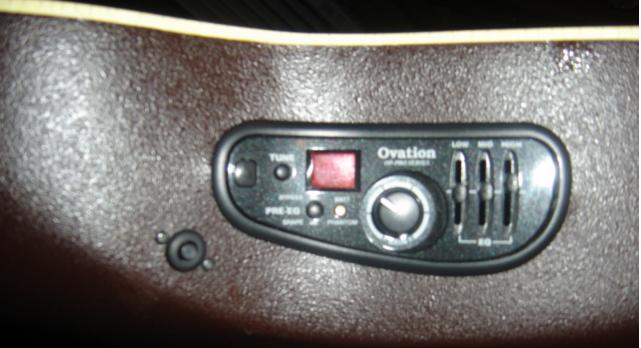

Here's a pic of the finished job (this was for another member on the board):
Does the one that you're installing come with both 1/4" and XLR outputs? If so, you'll probably need a template for the output jacks as well. I made that out of cardboard from the output circuit board itself. I don't have a picture of that one though.
This one already had a 1/4" jack, so the location was easy. If yours doesn't, you could put it anywhere you like as long as it's relatively flat.

That looks interesting! Yes, I do have a guitar with one fitted. Never thought of working from that, doh. I let the clay harden,remove any that has strayed into the hole and then mark out on the new one. Straight forward enough. lead me to the craft shop and a lump of clay. Fitting to a Folklore with early electrics fitted so jack alreay there but as you say will need cutting fo r the XL. I should be able to use the existing pietzo?

Paul - exactly! Not sure about the existing piezo. The two that I've done came with new pickups. If the jack is the same size, it should work.
