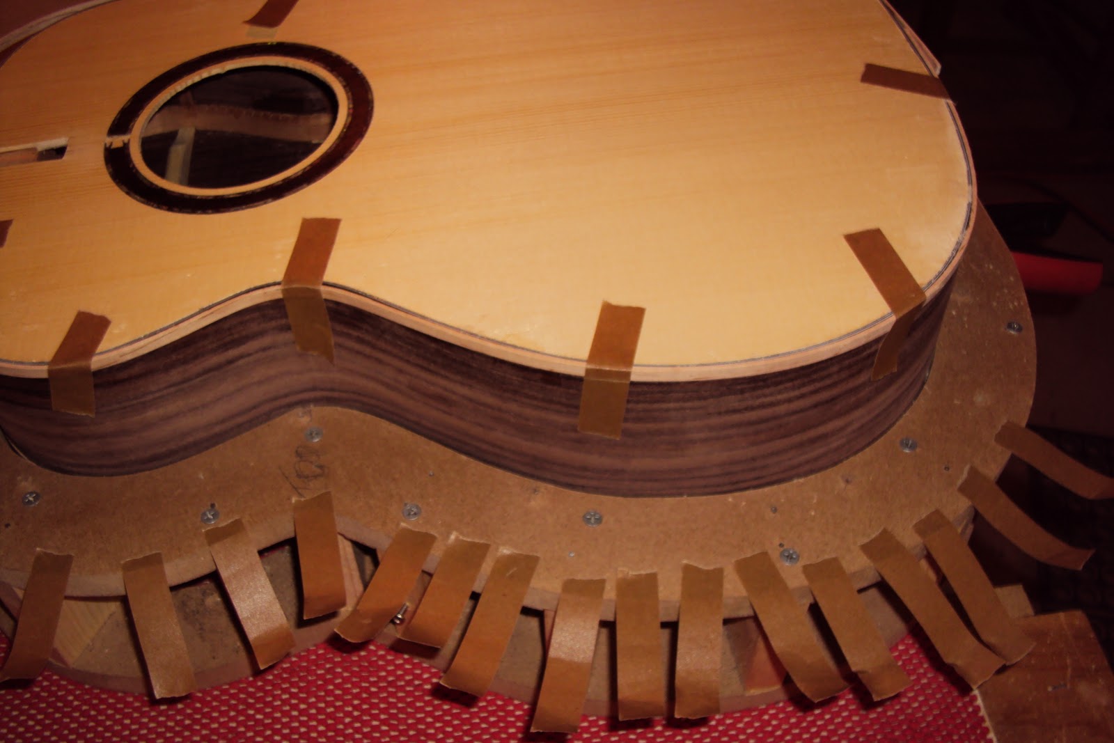

Another hobby/avocation of mine for the last 35 years or so has been designing, building and flying R/C model airplanes.
That hobby has a lot in common with all guitars, in general and Ovation guitars, specifically, such as the use of spruce, plywood, plastic and fiberglass and the ability to bond all of these materials together.
Modern luthiers have recently started using the same glues that we've been using for years in model airplane construction/repair and for the same reasons --low cost, ease of use and availability.

Below are a few pics.
1) Thin ZAP with one version of a tip that has a built-in capillary tube.
2) Thin ZAP with Z-End tip. Z-Ends come with capillary tube.
3) A small section of tube is cut and inserted into end of Z-End.
4) Sometimes, when I need to reach in deeply, I make a really long capillary tube tip. :D
On medium CA (Zap-A-Gap) I use the Z-End tip without the capillary tube.

You would also want to use the luthier's trick of tearing off as many pieces of tape as you're going to need beforehand and sticking them to the corner of your workbench so that you just have to grab the pieces of tape and apply them. This way you can keep one hand on the work and use the other to grab the tape rather than having to take both hands off the work while you tear the tape off the roll. (See: Binding tape photo) You could also use binding rubber if you're not happy with how the tape is working.
The main thing is that you'll need to pull the top/binding down and pull the bowl inward so it's tight against the kerfing.

Got it. Now I feel I'm armed with enough instructions thanks to you Dan. Need to go and purchase all my supplies - epoxy, tape, new strings, syringe, etc. In the meantime, I will begin cleaning the joints and make some practice runs. I'll let you know how it turns out. Wish me luck.
