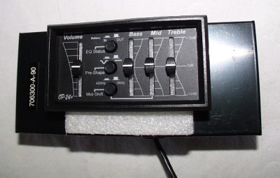

Okay... The OP-24E is just another in the family of similar preamp that includes the OP-24, OP-24+, and the OP-24+C.
Yours only has an "E tuna".
But all of that family of preamps has the same design...
This is the whole preamp module of an OP-24+.
I have never taken one out... But I know that underneath the black sticker on the front there are four screws/bolts, one in each corner.
I have owned Ovations that had those bolts showing.
So, I am thinking that if you carefully peel-back the corners you will find those screws.
Be sure to pull-off the slider knobbies.
Once you remove the face-plate screws, I think that the whole unit might fall into the guitar.
HERE is a thread that shows photos of OP-24+C units disassembled.
That might give you an idea of what you will be dealing with.
It seems that the output jack wire is permanently attached to the unit, at least by these photos...
So be aware of that when pulling it out.
You might want to disconnect the output jack first.
I hope that is helpful.

Hard to describe, but I can lift the slider as if to pull it through the face plate, but there is what looks like white plastic around the end with just a little of the lever metal below this plastic.
I don't know how the lever fits into the slider, but was hoping to take it out and fix it some how. I would need to access the preamp getting right to the slider, where the lever attaches.
I will try for a 4th time to get the face sticker off, it just looks like plastic to me, lol... flat black, red around tuning lights, and flees like plastic texture, lol... I usually fix all my own guitar issues, although not a luthier by any means.

After looking over all the pics, I see I would need to take the cover off the preamp, I do believe. Wish there were a detailed pic or schematic,,, I sent an email to Ovation, with description of what is wrong and what I "thought" needed to be done. Seeing these pics, hoping the cover off the preamp, I can access the lever/slider assembly connection.
Not sure until I get into it, but maybe a dab dot of cold weld for the lever end, plastic superglue to the plastic. This is rather stiff slider action on all sliders, so the don't vibrate and move. I don't think I could use heat on anything involving the lever or slider... too small, to close.. .
