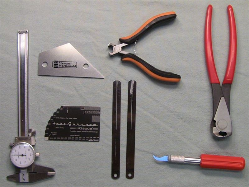

From left to right, top to bottom.
Caliper: This tool measures to the .001 of an inch. Almost necessary, definitely very helpful. Use it to measure your existing fret dimensions (width, height, and tang). Also very helpful measuring nuts, nut slots, saddles, etc.
StewMac fret rocker: This heavy tool is perfect for finding a high or low fret. Very helpful for finding and fixing a few trouble spots, but you don’t need this tool for a total refret or an overall fret leveling job.
Fret Guru fret tool: Does the same functions as the StewMac fret rocker, plus several others. This is the tool to get (though I like the StewMac tool better for finding a high fret). It has fret height notches to determine if your frets are too worn to file them down to level. It has several different measurement markings for setting up nut slots, bridge height, and truss rod adjustment. www.Fretguru.com
Fret puller: An absolute necessity. Flush ground and fairly narrow to get under frets easily. Spring loaded for easy use. You might find a cheaper set of nippers at the local hardware store and grind them down, but these work great and are reasonably priced.
Chip preventers: Not necessary but they really do work. Slide one under the fret as you are pulling it to prevent the fretboard from chipping out. Well worth the money. They save you a lot of time, fiddling, and frustration fixing chipouts.
Fret cutter: Necessary. This is a heavier and larger tool than the fret puller. Used to cut fret wire before installation and then to trim the ends right after installation.
Fret slot cleaning tool: A curved blade which fits a regular Xacto handle. I’d call it necessary, but you could use a regular Xacto type of knife instead. But these are so cheap and they work so well, just get one of these. If you already have an Xacto handle, just buy the blade.

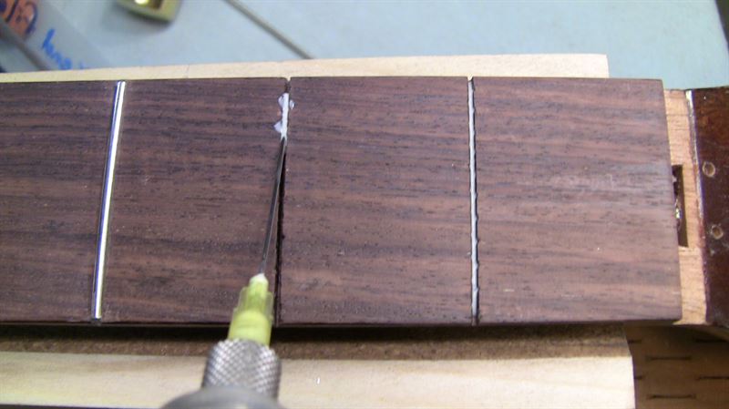

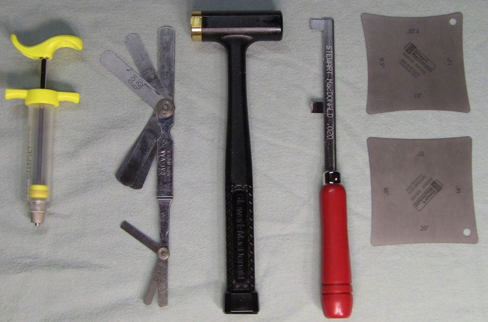

Syringe: This is a veterinary syringe sold by StewMac. Very helpful, almost a necessity. Use it to inject glue into fret slots or other tight places. Buy the mid sized needles. Smaller may work, but the largest won’t fit in the fret slots.
Feeler Gauge (thickness): Basic automotive feeler gauges are very helpful but not a necessity. Use the gauge to measure the width of your existing fret slot to be sure you buy the correct fret wire. Alternatively you can measure the existing fret wire tang with calipers, but it is more accurate to measure the slot itself.
Fret Hammer: Any version of fret hammer is fine. A necessity. Don’t use a regular hammer to install frets!

Radius Gauges: A necessity for a really perfect fret job. Use to measure your fretboard radius before and after sanding. Ovations are 10” radius, but if it’s been sanded by someone else it could be different. As you’re sanding, use the radius gauge to verify you have gotten the fretboard properly shaped along the entire length. A perfect wood surface is the foundation of a really good fret job.

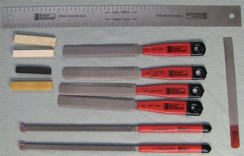

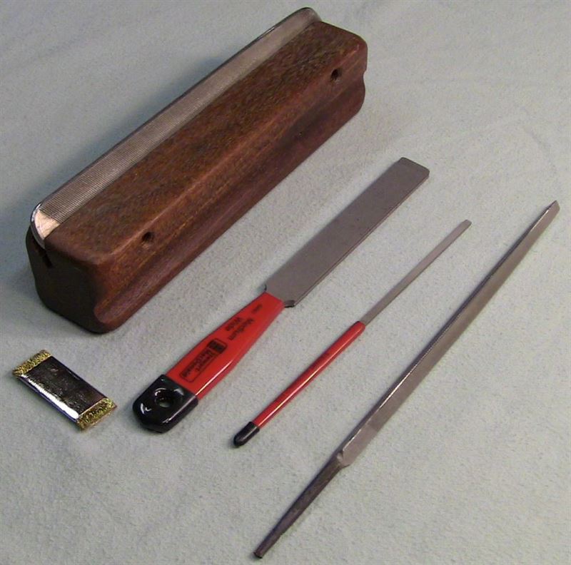

Bevel File: Use this to put a bevel on the edges of the new frets. I call this a necessity but you could hold a file by hand at an angle to file the edges. This tool is way better than doing that! I got this file from CB Gitty. Be sure the narrow edge of the file is very smooth. If it contacts the top of the guitar it can damage the finish if there are any file teeth left at all. Use a grinding wheel and 400 grit wet/dry sandpaper to get that edge really smooth.
Fret Crowning File: Almost a necessity. Has concave edges which file the top of the fret to the proper shape. You could use a small flat file to round off the top of the fret but that is a lot of work and prone to damaging frets and fingerboard. Buy a crowning file which matches the crown dimensions of the fret wire you will be using.
Fret End File: Small file for carefully filing the ends of the installed frets flush with the edge of the neck and for smoothing the ends. The narrow dimension of this file is smooth so as not to damage the wood. Necessary!
Triangular File: Optional. You can smooth the three corners of a regular file so it won’t damage the wood. This file could be used to crown frets and to file the ends. I really don’t recommend this method.
File cleaning brush: The files will clog with debris and need to be cleaned. This little brass brush from StewMac works better than other file cards or file brushes because the bristles are very small. It is actually a “Brass Scratch”, but works great as a file cleaner.

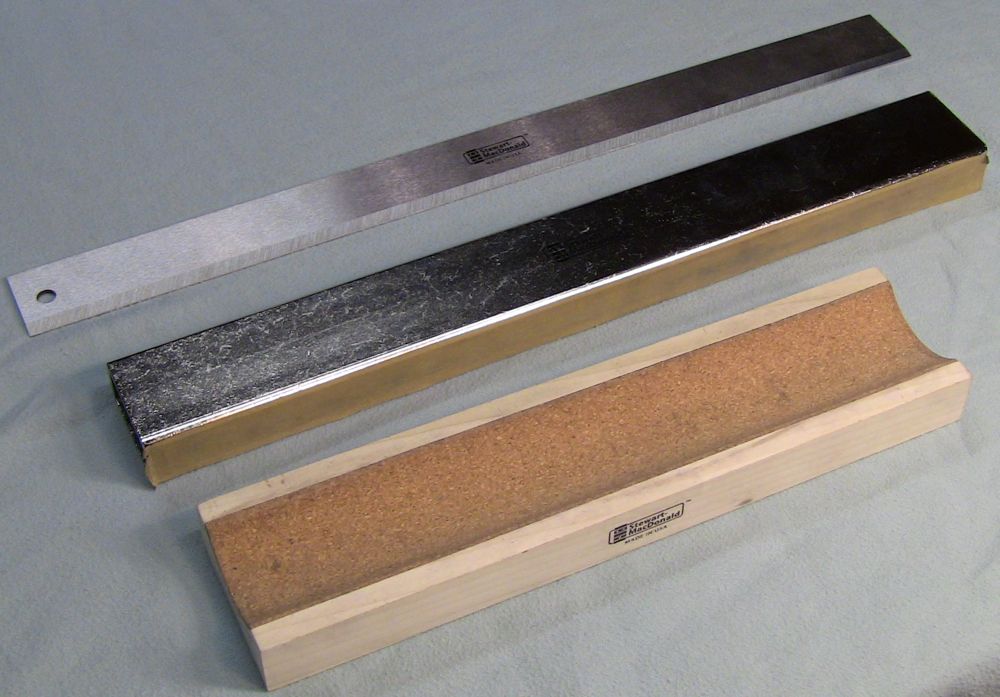

Precision Straight Edge: Necessity! Get the 18”. You have to get the neck straight before sanding by adjusting the truss rod. This tool is also used to verify you have sanded the wood properly. It also confirms your frets are leveled properly. The notched straight edge may be useful for partial refrets but costs more. Using the next tool in the photo, the fret/fingerboard leveler, to check for level is very difficult. If you are really trying to cut costs to an absolute minimum, you could try to get by without the Precision Straight Edge. In which case loosen the truss rod completely and then sand the fretboard level.
Fret/Fingerboard Leveler: 16” long precision ground flat sanding beam. Necessity. This tool sands the wood or the frets to a very straight line. If there are any humps or low spots in the neck, this is the tool to remove them. You might get away with using a radius sanding block without first using this beam, but it would take a lot of extra time stopping and verifying with your precision straight edge. An alternative would be the
Aluminum Radius-sanding Beam, which costs twice as much.
Neck Support Caul: Necessary. Some version of this is needed to safely hold the neck. Lined with balsa to protect the finish. Either buy this or make something similar.

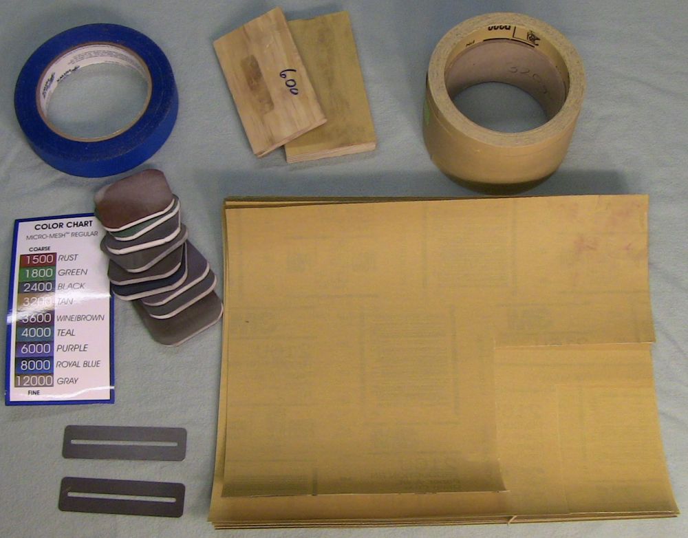

Blue Painter’s Masking Tape: Necessary. A regular 1” roll works, though a narrower tape is needed for the upper frets. Get a 1/2” roll if you can find it. Otherwise you’ll be cutting the tape into narrower strips.
Sanding blocks: Use scrap wood and a spray adhesive to attach sandpaper. Label the back side of the block with the grit #.
3M Stikit Roll Self Adhesive Sand Paper: Optional but handy. One roll will last a long, long time. Most useful for the fretboard leveler. 320 grit is perfect for leveling. You could trim sheets of sandpaper and use a spray adhesive instead. Call this one very nice to have but you can get by without it.
Micro-Mesh Soft Touch Finishing Pads: Optional but very helpful. Use to polish anything. Final polish of the frets, remove scratches in the clearcoat, etc.
3M Gold Fre-Cut Sandpaper: Sheets of sandpaper. Necessary. 320 grit, 400, 600, and 800 will all come in handy for sanding the fretboard. One sheet lasts a long time. Much better than home improvement store sandpaper! No rogue large pieces of grit which leave scratches. One sheet of each will be enough for several refrets.
Fingerboard Guards: Optional. These look like old fashioned razor blades. Place one over the fret and it protects the fretboard. Good for polishing the frets without having to use masking tape. I don’t use them very often.

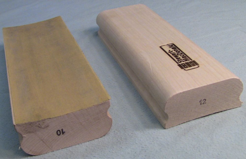

Radius sanding blocks: For your Ovation you’ll want the 10” radius, which is the curve geometry. Buy the 8” long block. I call it necessary, but you could use the beam sander and check frequently with the radius gauge all along the length of the neck to ensure you are keeping the radius correct.

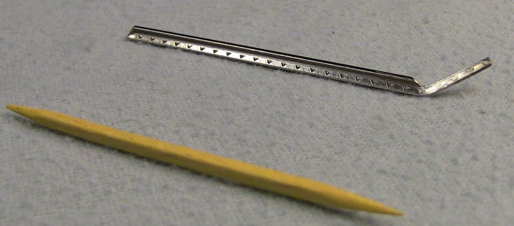

Fret wire tool: This is a homemade tool. Made from the actual fretwire you intend to use. It is about the same length as a tooth pick. Carefully file off the crown at one end and bend the tang into a little foot. Use this to measure the depth of the fret slots. If the slot is deep enough the foot will be below the surface as you slide it along the slot. This is a quick way to verify your slots have been sufficiently cleaned of old glue. You’ll have to file the barbs off of the tang to narrow it enough to slide in the slot.

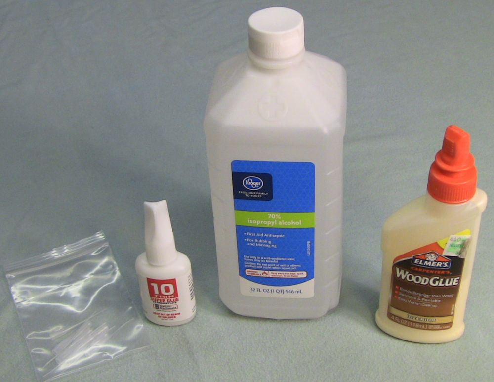

Super Glue: You’ll need some thin cyanoacrylate glue and applicators. The StewMac glue and their “whip tips” work very well for repairing chipouts and small cracks.
Alcohol: Fretwire must be degreased before use. Regular grocery store isopropyl alcohol works fine and is cheap and safe.
Wood Glue: A good carpenter’s glue is a necessity.
Acetone: (not shown) Optional. Will degrease fretwire and dissolve old glues. If you replace binding you’ll want acetone to remove glue residue. Will dissolve plastic bindings. Doesn’t seem to affect Ovation/Adamas neck clear coats, but check an inconspicuous spot. Can be used to remove old superglue.

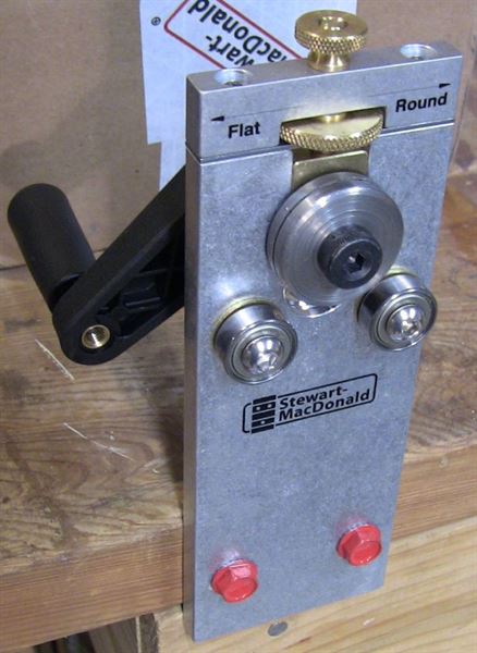

Fret Bender: This is almost a necessity, especially if you’ll be doing multiple guitars. If you’re only doing one guitar you could try manually bending the fret wire with pliers. The key is to have the fret wire bent to an even arc, which can be tricky by hand. This tool isn’t cheap but it works so well and so quickly.

Nut Making Tools: If you replace your nut you'll need some additional tools. At this time I'll give some tool recommendations so you are aware of what you're getting into but won't discuss actually making a new nut. There are plenty of tutorials on the web which cover it quite well.
Chances are your old nut will be too low and you’ll have to install a new nut. If you’re going to make a new nut you’ll need some specific tools. A StewMac string layout ruler is very nice but not necessary. It lays out the spacing of the nut slots. Very very helpful. You’ll need a set of nut slot files. Get the more expensive rigid files, not the cheaper flimsy files. The flimsy ones bend easily and bind up in the nut slots. They don’t cut very quickly either. Nut shaping files are very nice to have but not a necessity if you already have some wood files. Finally, you’ll need some blank nuts. Measure the nut you’re replacing in order to get the correct replacement. I’ve found bone to be easier to work with than Tusq or the black GraphTec blanks.

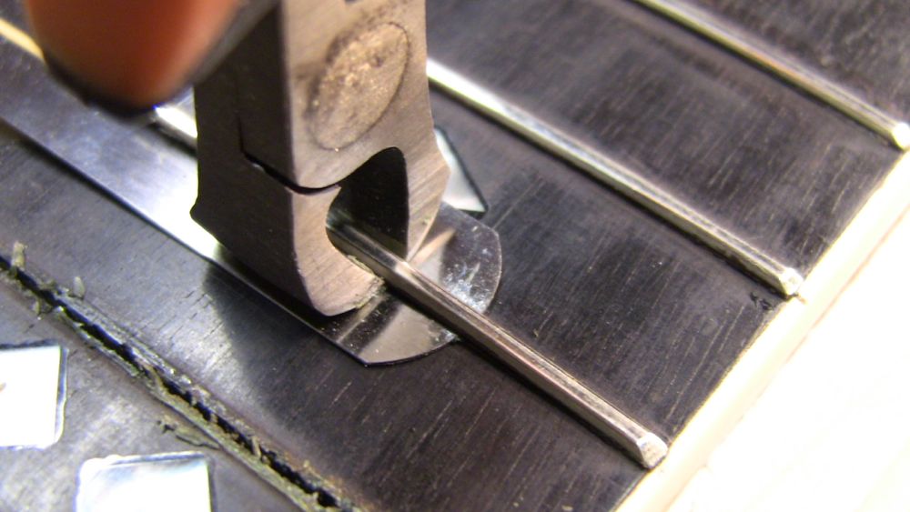

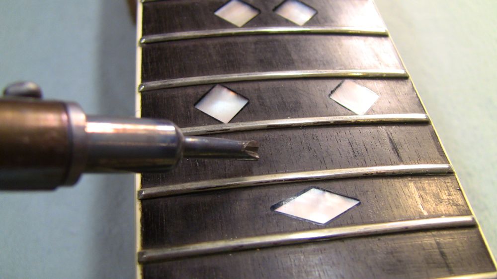

Pulling frets:
To pull frets, first heat them with the soldering iron. Let the iron heat for 5 minutes or more. Then hold the tip on the fret for about 10 seconds at one end. Slowly move the tip along the fret, taking a couple of seconds or more to go from one end to the other. After about 30 seconds remove the iron and use the fret puller.
As with almost all the tools and operations involved, use a loose grip and a gentle to moderate force. You’re not framing a house or wrenching on a car! So use a relaxed grip on the fret puller and gently rock it as you squeeze. When the tool is aligned with the fret you will feel it grab position. Then squeeze moderately to get the jaws under the fret. If it doesn’t go easily, it isn’t aligned properly. Squeeze the jaws under the fret, then slide the jaws a bit and squeeze again to lift a bit more of the fret. Don’t pull the fret out, just lift the fret the amount that the tool goes under.
Now use one of those chip protectors by sliding it under the fret and placing the fret puller on top of the protector rather than on naked wood. Work along the fret until it comes loose. I find chipouts usually happen at the other end from where I started. In this photo a chipout is more likely at the bottom right end of the fret, so go a bit slower and more gently as you pull that last end free.

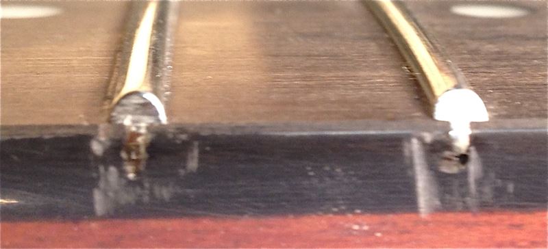

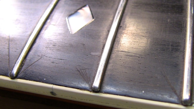

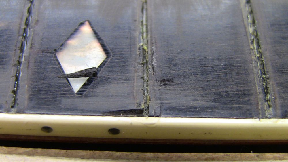

Fixing Chipouts:
If you get a chipout, fix it immediately before pulling the next fret. Place the chip back where it came from and wick some thin CA glue. The StewMac whip-tips are perfect for this. Don’t worry if a bit of glue gets on the surface of the fret board or down in the slot, but try to keep the mess to a minimum. Use a toothpick to press the chip in tightly if you can.
Here’s a picture of a triangular chip that came out. The chip is sitting on top of the pearl inlay, the hole it came out of is next to the binding. Notice, too, the mess created by using superglue (cyanoacrylate or CA) to glue in frets. Have mercy on the next person to do fret work and don’t use CA to glue in frets!

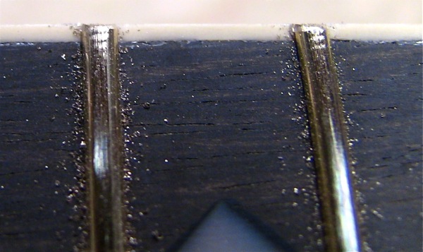

Cleaning fret slots:
After you’ve pulled all the frets you’ll have to clean out the slots. Use your slot saw carefully to do this. You don’t want to widen the slot, so use straight motions and keep the saw aligned both vertically and along the slot. Use a relaxed grip on the saw! Move the saw slowly, taking about 1 second to go from one end to the other of the slot. You’re not sawing a 2x4 to build a house, you’re doing precision work here. Use care not to slip and damage the finish on the neck, especially if you’re using the 2 bladed StewMac saw. A minor scratch on the fingerboard won’t matter because you’ll sand it out later, but still try to be careful. If the neck is bound, use a lot of care not to bang into the binding with the saw because the binding will come loose quite easily. A block of wood held against the binding can help prevent it from being knocked loose.
Use the fret cleaning tool to get the bits out of the slot, and use your home made fretwire tool to ensure the slots are deep enough.

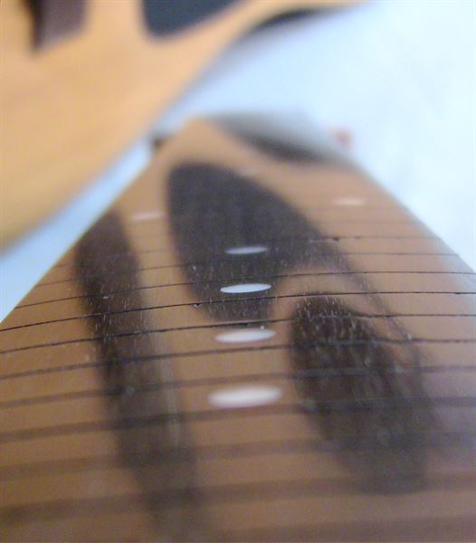

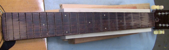

Sanding the fingerboard:
Once you’ve gotten the slots cleaned out deep enough, it is time to sand the fretboard. Loosen the truss rod all the way (you can do this as soon as you take the strings off the guitar). Use the straight edge to verify the neck is straight. Some necks need a tiny bit of tension on the truss rod. Use care in this step. There may well be a hump above the guitar body on an acoustic. So adjust the truss rod so that the neck is straight through the middle part. I’ve found several necks with a hump in the 14th to 20th fret area, and also in the 1st fret area.
You can loosen the truss rod all the way and then sand the entire length level, but it is more work than is necessary.
I remove the nut and tuners, and protect the top of the guitar from accidental scrapes.
The first few passes of the beam will show where the high spots are, as seen in this photo where the 1st/2nd fret area is high, and the 18th/19th fret area is high.
Use the beam to sand out the humps. Use a relaxed grip on the middle of the beam, and let the weight of the beam do the work. Move slowly, taking up to 2 seconds to go all the way from one end to the other. Again, you’re not doing rushed work on framing a house, so take your time and don’t use too much force. Check your work frequently. Use the radius gauge to verify you are not changing the shape of the curve significantly.
Start with 320 grit paper. Use the straight edge frequently to verify the entire board is level. Then go to the radius block with 320 grit to get the curve even all along the length of the neck. Use the radius gauge frequently. Then double check with the straight edge that you’re not creating low spots. This step is one of the most important, so take your time and be precise.
Once the shape is correct, switch to higher grit papers. 400, 600, 800 of the tan fre-cut paper. You can use a plain flat wooden block or you can glue the paper to a radius block. When you remove old paper, fully remove all the glue. Any glue bits will become high spots on the new sandpaper and will gouge the surface of the wood.
After 800 grit you can go even higher using wet/dry paper up to 2000 grit. The little polishing pads also work well, but sandpaper is cheaper.
Once the board is sanded to a fine finish, recheck the depth of all the fret slots to be sure they are still deep enough. Then use a triangular file to knock the edges off the top of the fret slots. Fretwire has a slight roundness to the underside joint between the tang and the crown, so your slot needs a slight bevel at the top so that the fretwire will seat all the way flush with the top of the fret board.

Use diluted carpenters glue, approximately 2 parts glue to 1 part water, and run a small bead into the first slot. Using many light taps with the hammer, seat the fret. A little bit of glue will spit out the ends of the slot, so wear older clothes and don’t work at the fancy dining room table. Don’t hit at all hard with the hammer or you’ll deform the fret making it unusable.

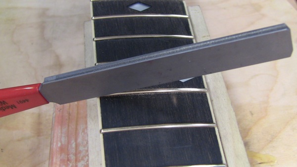

Leveling and polishing new frets:
Be sure to protect the top of the guitar and the headstock, especially during this part of the process.
The next step is to level the frets using the sanding beam and the 320 grit paper. Lightly run the beam once across the frets, covering the entire span of each fret. Now look for where frets have been flatted slightly by the sanding. Those frets are a bit high. Now slowly and carefully beam sand until all the high spots are down level with the other frets, but don’t sand down into the lower frets.
Use the bevel file to bevel the ends of the frets. File all the way to the edge of the fretboard, but not into the wood. If there is binding, use care not to remove any of the plastic which is soft and files away easily. Run your fingers along the length of the edge of the fretboard to find fret ends which poke out. If you hadn’t filed the ends of the fret tangs flush earlier, now is when you’ll really feel it.
Now you can tape the entire fretboard with blue tape. Don't tape prior to this point or you'll gum up your files and fail to get the fret ends filed flush. Get the tape up against the frets but not riding up the side of the frets.
Crown the frets with the crowning file. Mark the top of each fret with a blue Sharpie, then file slowly and carefully until just a sliver of the blue remains along the top of the fret. You only have to crown frets which were sanded. The un-sanded frets already have a smooth crown on them.
Use the end file to smooth the bevels. If you don’t tape the fretboard you’ll put tracks on the wood like these. Files without a smooth edge will also leave these tracks.

Here is a quick addition about crowning frets using a concave fret file. These files work very well but can put chatter marks on the ends of the crown at the edge of the fretboard if the file angle gets too steep. It can be felt as a rough stepping of the file as it goes over the end of the fret. Here's a picture of the chatter marks and a picture to illustrate in an exaggerated way an incorrect angle of the file which causes the marks.
