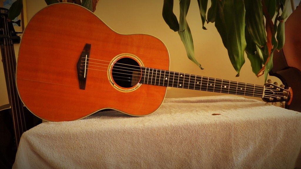

clrules
Posted 2015-06-27 6:49 AM (#512973 - in reply to #512963)
Subject: Re: Loving the 68 Balladeer
September 2005
Posts: 138
Location: Birmingham, AL
Here's a front shot......
I like the Tusq also because it's not too soft and will hold up to wear. The old nut had worn down to where the open strings were buzzing. I plan on replacing the bridge saddle also the one that's in there now is the wrong thickness and leans forward under string tension.
BTW this one is #2486. It has the thicker binding on the top it's just like my CL. But it has the shiny bowl which is really nice don't know why they went with the matte finish.
I bought the Custom Legend new in late 1975 and have always thought it sounded really good been holding on to it for 40 years still like it but this one (to me) sounds much better.
One thing I do like is the much simpler rosette. It has a nice understated look unlike the more common one.
