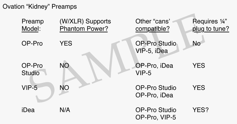

If such a thing already exists, I missed it, (and would appreciate a link), but otherwise:
A search of the OFC finds plenty of discussions about preamps, phantom power, cans, etc., etc., but the information is scattered, some of the "facts" are not in agreement, etc.
Jérôme's site has manuals for the pre-amps (which are very useful, thanks Jérôme!), but, again, unless I looked in the wrong place, there's no simple complete comparison listing. I'm willing to put such a thing together, but I don't know even half the facts about the darn things. Below is an example list (which is almost certainly inaccurate) with a few preamps to illustrate what I had in mind.
Any thoughts/input?

I don't believe that the iDea or the OP-Pro Studio needs to be plugged-in to use the Tuna.
Only the VIP-5.
Also, all of these preamps will function in an OP-Pro can...
BUT! I know that an OP-Pro will NOT function correctly in an iDea can.
(also, the battery on the OP-Pro will drain when used with an iDea can)
How about the OP-2B, OP-10, OP-11, OP-20, OP-30, OP-40, and OP-50?

Old Man Arthur - 2017-04-14 9:19 PM
Only the VIP-5.
That's good info OMA. I only intended the above "chart" to be a starting point for discussion, not a complete list (although a complete list would be the ultimate goal.)
If others agree that some sort of chart would be useful (and contribute what they know) (and if Miles &/or
Al have no objections), then this thread could eventually be the source of a more complete and accurate pre-amp FAQ/chart.
My initial objective was simply to ask if anyone besides me thinks it might be useful to compile such a chart/list in one place for future reference.

it might be simpler to create two separate reference charts:
- One for the older preamps that don't pop-out of a "can"
- and another for the "kidney" preamps, since some of
those can easily be swapped between guitars.
Does anyone know how many different "cans" there are (and what preamps work with which.) Is there a simple way to visually differentiate the cans (without having to remove them from the guitar?)
(I freely admit that I don't know half of what I'd need to create a complete list. It was a search for such information that gave me the idea in the first place.)

standing - 2017-04-15 11:55 AM
All of the OP-Pro style cans have 8 contact points.
The silver OP-20/30/40 cans have 6 contact points (some say 7).
But the OP-30 style of contacts are staggered, whereas the OP-Pro style is 8 in a block.
You generally would only encounter an iDea can on an iDea guitar...
Or a guitar that has a little Aux jack on the back of it.
Otherwise and iDea module will work in an OP-Pro can... Unless you need the Aux jack.
