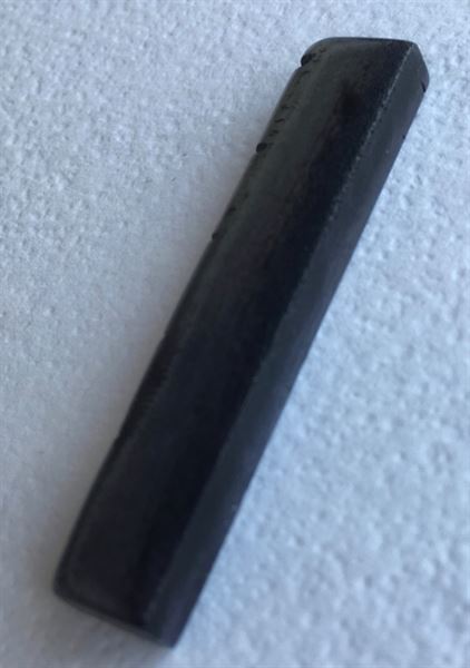

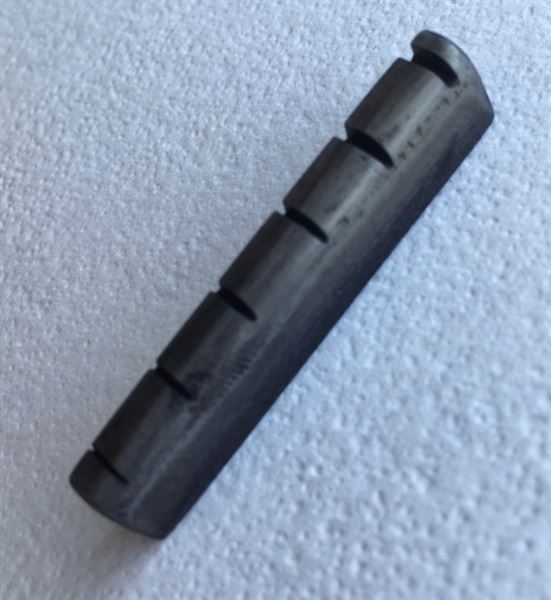

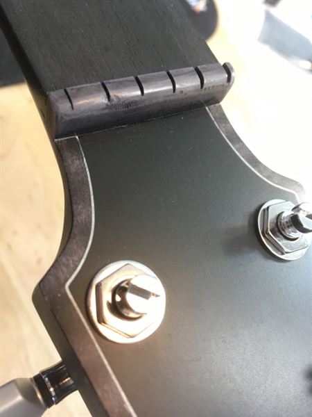

There's been some success!
I used a black water soluble aniline dye powder from Luthier's Mercantile. Mixed with just water the dye did not penetrate at all. The nut is unbleached bone and has a slight oily or fatty feel to it. So the next step was to wipe down the nut with alcohol. Acetone may have worked better but I didn't want to weaken the bone. In hindsight, using a bleached bone nut might work better but I didn't have any on hand.
So the next step was to mix the dye with 70% isopropyl alcohol from the grocery store. I figured this would penetrate the oily areas better, and it did. But it still took 5 days in the dye to get results. The alcohol evaporates quickly, so the tray has to be covered and the fluid level checked daily. The penetration was very shallow still, but enough to actually be a stain rather than a surface coating.
Some areas of the bone took a nice dark staining, but of course those turned out to be the bottom portions. For this guitar the mottled look matches the neck trans-black well enough.

Thanks for sharing FlySig! It really looks sweet. I never thought I would get used to those new Adamas headstocks, but they actually look great with the black nut... Pleasing headstock or not, your Adamas has got to be an awesome sounding guitar out of the box. Does bone improve the guitar's voice?
