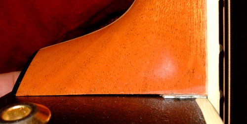

Well, I had to take the deception to new depths, but the '05 is now out of the garage.
A colleague and I hatched a 'story' that had him 'giving' me this 'project' that he'd given up on.
I feel good coz I can now work on the guitar out in the open, but bad because of the level of deception.
I've now got the action to close to where it should've been in the first place, but the frets now need some professional attention. (I had to pack out the heel with about 1 1/2 thicknesses of credit card to get the neck straight)
Now that I know how much packing is needed and got it straightened out, how do I get rid of the ugly gap? Do I shave off the excess from the bottom of the heel, or use some sort of filler?
The professional way to do it right! A solid neck set and one that looks great as well.
Blessings...

After holding back my GAS for years, I finally broke and bought my first ever NEW Ovation. I waited full of excitement and anticipation for weeks and weeks and when it finally arrived, I was gutted! The neck was way wrong, you could fly a small plane under the strings - my Hondo plays better.
Ovation won't honor the warranty unless I return the guitar to the dealer that I bought it from (Victor Litz). Shipping each way would equate to another 2 or 3 US Ovations in my collection.
The mother ship suggested I contact the Aussie importers, who then put me on to their 'recommended' luthier, who was just going to pack out the heel, but I wanted it done 'properly', as some have agreed to above.
I suggested to the luthier that it would need substantial packing, as the neck was aiming nowhere near where it should be. I didn't get a good vibe from the luthier (the brushoff effect) and decided to see just how much it needed packing out - hence my temporary DIY investigation.
As you can see, it needed quite the realignment.
Now I've got the action close to where it needed to be, but I've gone as far as my ability will allow. Really, in a practical sense, I just need a fret dressing and a final tweak of the truss rod to get her playing like an Ovation should.

Looking at the picture, I'm trying to imagine how the guitar was able to leave QC if the bottom of the heel was pulled away from the body that much (the inverse of how much you've packed out the top of the heel). Was the neck built wrong to start with? Was it attached wrong? Did it move during shipping?
I don't expect you to answer those questions, but they're the things that pop into my head and make me go, "hrmmm." An interesting (for me) problem to be solved, as I like to figure out how things get/got the way they are.

Cruster - the guitar LOOKED fine when it arrived. It wasn't until I played my first chord that I noticed it wasn't what I was hoping for.
The guitar was cosmetically well made (for me, it's the perfect Ovation) and the heel was snug (and gapless) against the body, but the angle of the neck to the body was wrong. (If you looked at an acute angle along the neck from the bridge end, the top of the fretboard lined up with just below where the bridge is attached to the soundboard. My 1768 lines up near to the top of the bridge)
I've adjusted the angle with the packing, hence the gap.
